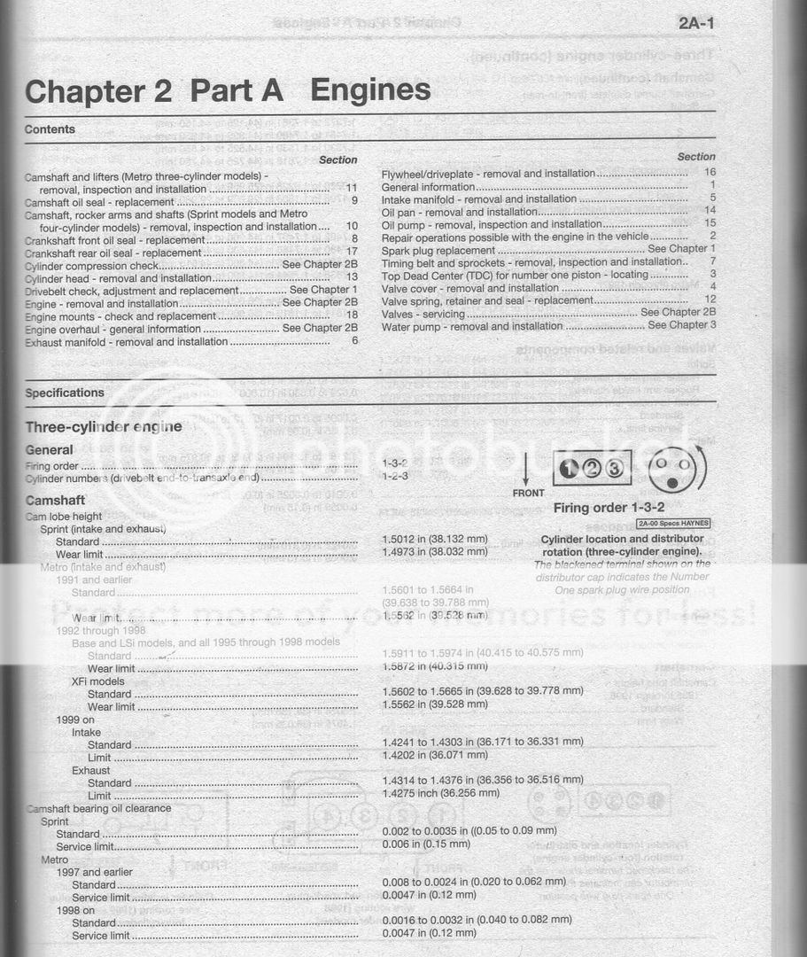

Here you go, this has some of the lobe specs. That's how I doubled checked that my cam was XFi.

Standard is 40.5 mm, XFI is 39.5 mm |

Thank you everybody for the information. It was exactly what I was looking for. Now for the rest of the story. It is an XFI Cam. the bad news. It's at its lower wear limit. Now the question, should I attempt to install this into my 97 metro that's already tank averaging 47.5 mpg?? You're imput is needed......... Thanks again, Steve |
