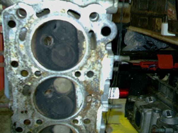

This would cause 0 compression.............
| GeoRating | May 8 2011, 09:56 AM Post #10 |
Wow I didn't realize such wear on the valves would cause ZERO Leave it to Johnny yo be the expert
