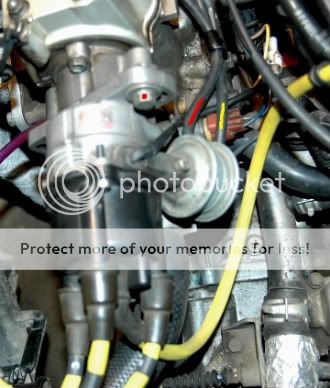

There is a thermo switch located close to the distributor on the right side of it that controls the electric fan. Unplug the connector to the switch and put a jumper wire between the black/white wire and the blue wire and see if the fan comes on. If the fan comes on, replace that switch.
Could someone post a pic highlighting the radiator fan switch please?? Thanx.

Jezza
May 17 2011, 11:34 PM
enginedoctorgeo
May 17 2011, 07:59 PM
I see a brown "socket" just above the vacuum advance on the distributor, in this picture. Blue wire is right next to the coil wire in the picture.
