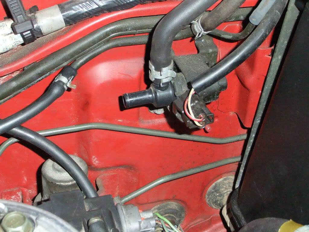

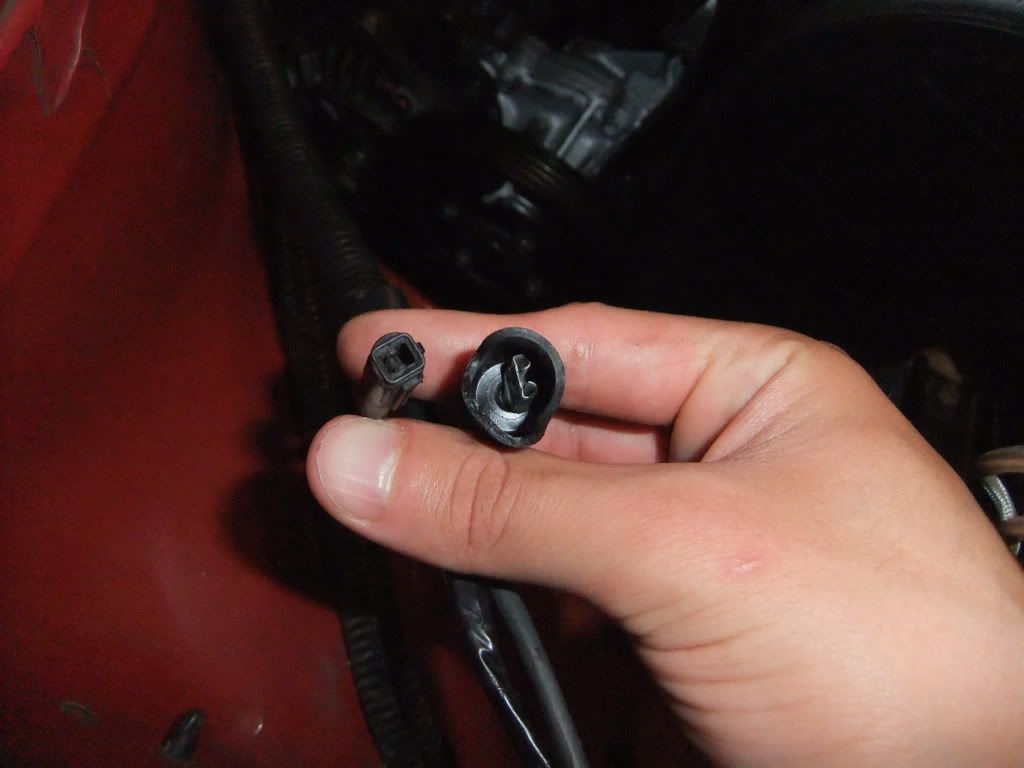

The connector on the left looks like it goes to the AC compressor
The connector on the right looks like it goes to the oil pressure sending unit (screws in the block directly above the oil filter)

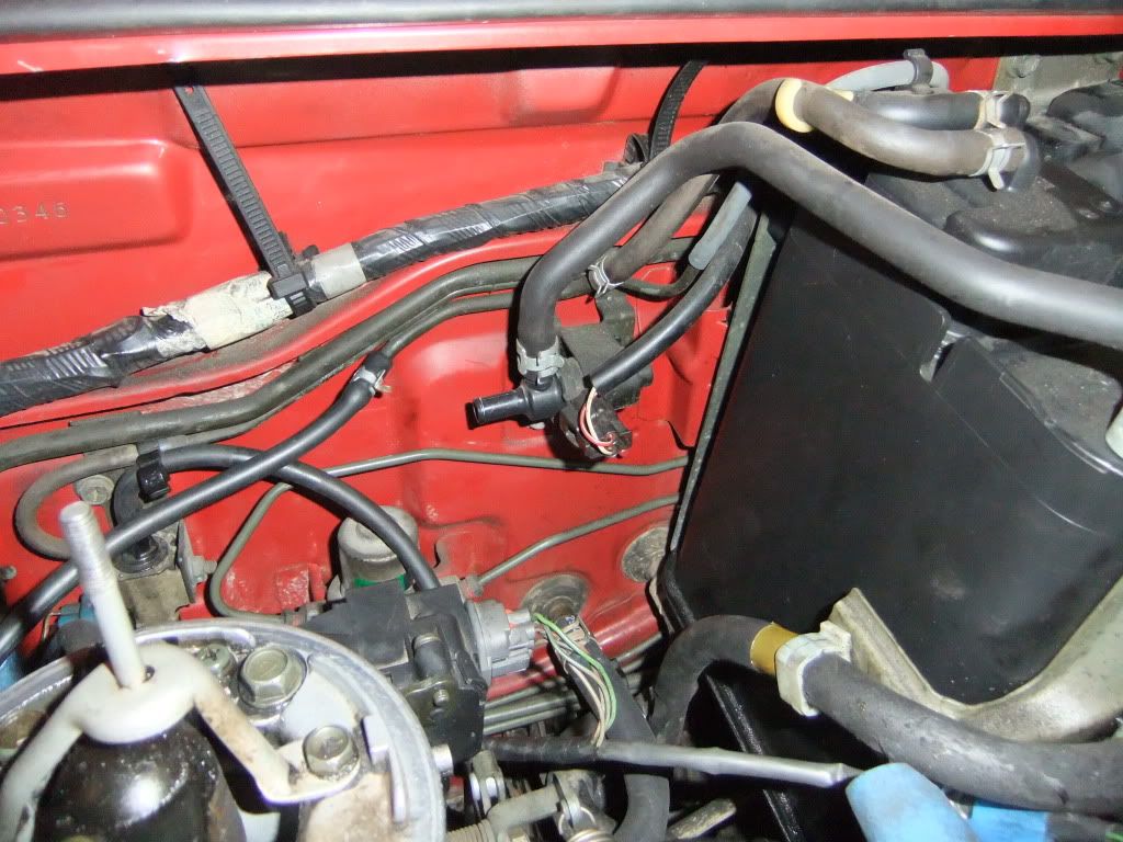

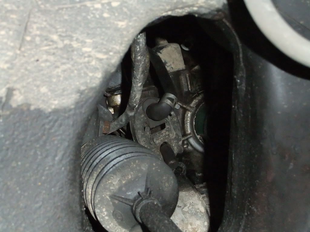

The large vacuum hose coming from a hole in the right side of the body goes to the bottom of the charcoal canister (plastic rectangular box next to master cylinder)
I couldn't find any nipples under the charcoal can, I found this one beside it though:
Is this what you were referring to? If not, what's supposed to go here?

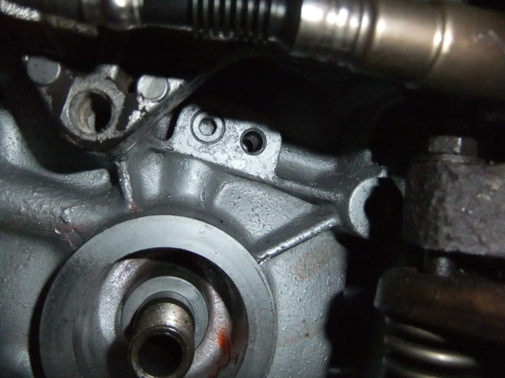

And is this the oil pressure sending unit you were referring to?
I'm clearly missing the "screw in" portion lol can I get this piece anywhere or would I have to go through GMC to get it?
On my car, a 96 3 cylinder, the hose coming out of the right side body goes to a nipple on the bottom of the canister. GM must have changed the emissions on the 98. A hose is clearly missing from the nipple in the picture you posted.
Regarding the oil pressure sending unit. I would think you could buy that from a local parts store or GM

Alrighty so I took a closer look at the pictures I took before starting the rebuild and I'm fairly confident that the vacuum line coming from the sidewall does indeed connect to the nipple beside the evap can. Last night I bought a oil pressure sensor, screwed it in, added the oil filter, oil, changed my radiator fluid and put on my alternator belt.
