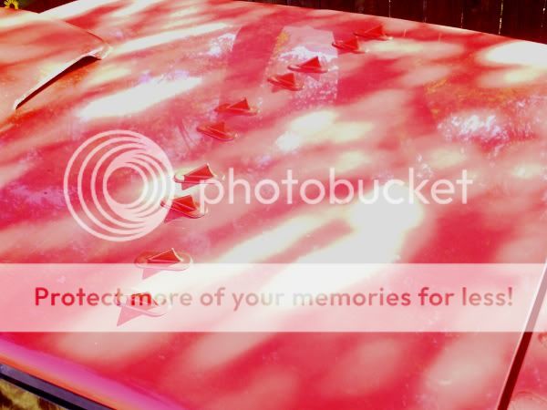

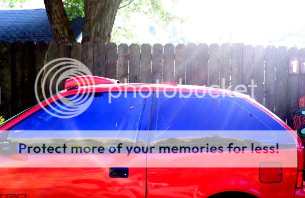

So, let me update this with a few pictures. Here is the arrangement of the tabs. In moving them I kept the original angles, pretty much. ![]() Pretty close to a side view... ![]() A thumbnail of them, at an angle. ![]() I did do the tuft testing, Wanna Beco, which is why I moved them forward, closer to where the roof breaks and begins sloping toward the hatch. I have not taken the time to repeat the test. My mpg has been stable at 55 mpg for the summer. I believe lowering the back of the car may have gotten me 1 mpg but I only filled one tank. |

Thanks for the pics BB. Wonder if you could make them yourself? Looks like the profile of a shark's dorsel fin. Hmmmm. How wide would you say they are? Do you think the width makes a difference or is the angle of attack the thing that creates the swirl effect. Hmmmm, shark fin. I might experiment. Hmmmm |

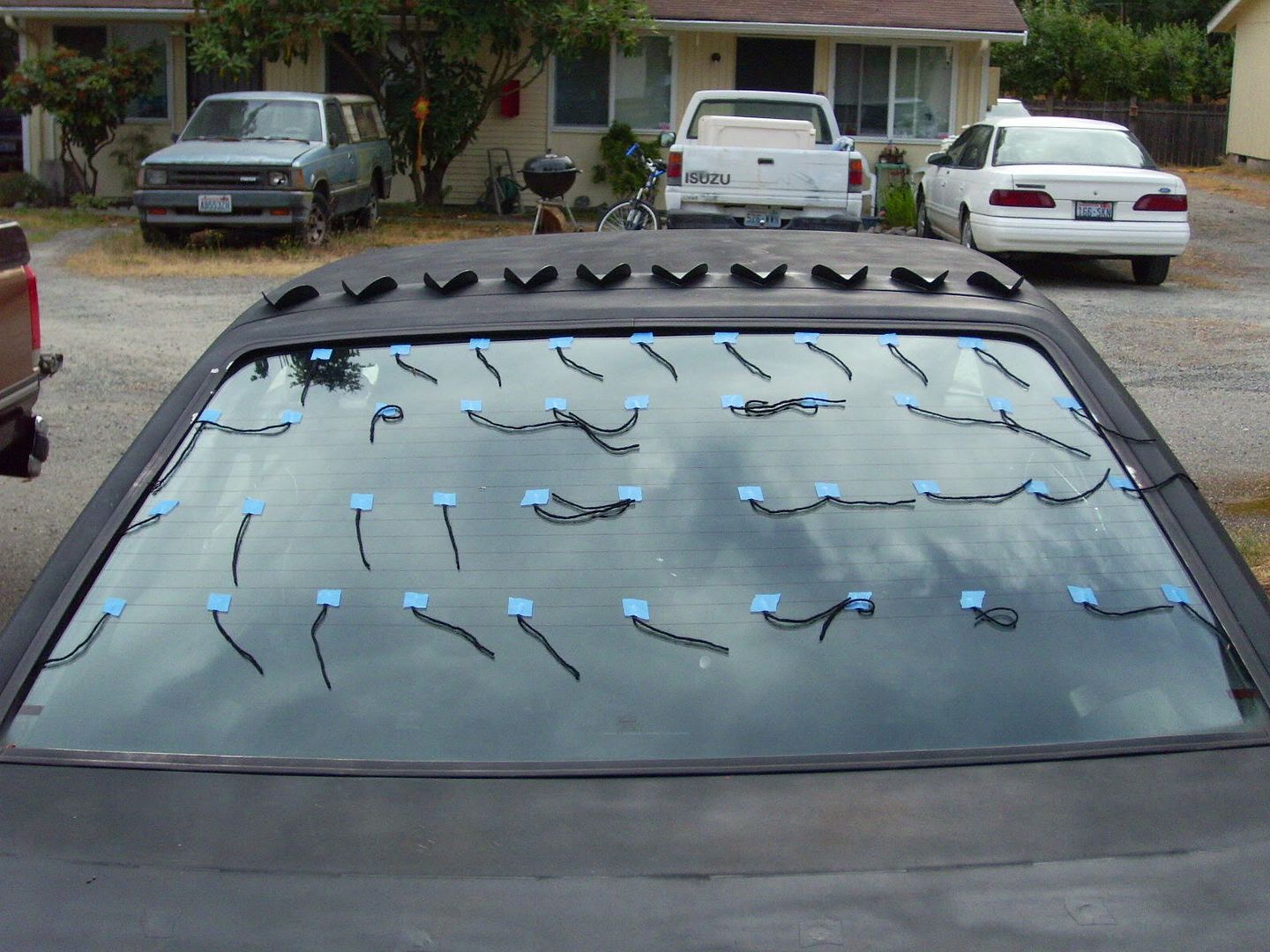

Here is a good thread at http://www.gassavers.org/showthread.php?t=1482 Including picks like these: ![]() ![]() ![]()
| Johnny Mullet | Aug 18 2011, 10:03 PM Post #20 |
I had them on my 98 but did not notice any increase in fuel economy. My rear window stayed cleaner though! |
