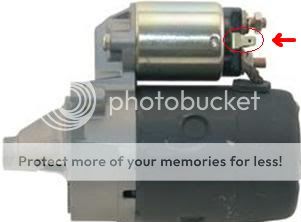

If you have a Digital Volt/Ohm Meter (DVOM) you can check the Cam/Crank position sensors: http://geometroforum.com/topic/2703156/1/ Also the wire on the starter: ![]() And My favorite in my '91 is the floor mat riding up and under the clutch pedal so the switch does not make contact unless you push really hard. What were the last 3 things done to the engine and electronics? |

Thanks, I will go through these troubleshooting steps. In the meantime, I have cleaned the grounds that I could find (1 near the ECM from pile of ECM wires to chasis, one right next to the battery from battery to chasis, one on throttle body and the big guy right from the battery to the transmission case. I also looked in the throttle body and I can see fuel pearling on the butterfly valve, can't really see the conical spray from the injector, I think it is just obstructed from view. But there's fuel nonetheless Car started up fine before all this a few days ago, and after cleaning grounds it started fine as well. Went for a ride and she died again, this time while driving (that was a first, although I may have been coasting in which case it is similar to the few stalls I had at idle). So I opened up the hood right away as this was a primo chance to do troubleshooting (which is hard with an intermittent problem, hard to find the issue when everything is working). I pretty much immediately saw the butterfly valve was bone-dry, no fuel being injected. Could be injector or fuel delivery issue (pump, filter). I can hear the pump prime, that's good. I pulled the fuel line right where it enters the engine bay, no fuel. So at this point I'm thinking fuel filter (the sock at the fuel pump, it's a '98). This is purely a theory, but she seems to start ok after sitting for a while, my theory is that fuel slowly seeps through the now clogged filter, so I have just that little bit of fuel to work with. |
