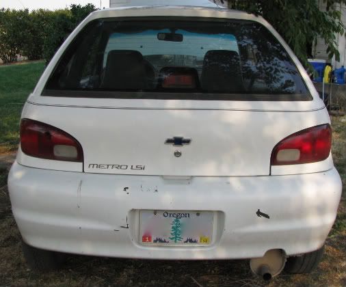

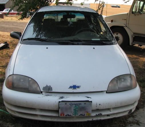

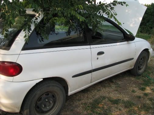

3 weeks ago, I bought this 1998 1.3 automatic that had no reverse.
They had just put new radials on it 3 months ago.
http://bend.craigslist.org/cto/2534854314.html
The owner only wanted $250.00 and I needed the tires for my main daily driver.
I bought it for the tires and figured the car was the cost of going to get it.
(3 1/2 hours each way.) and $80.00 in gas in the big white van in the background.

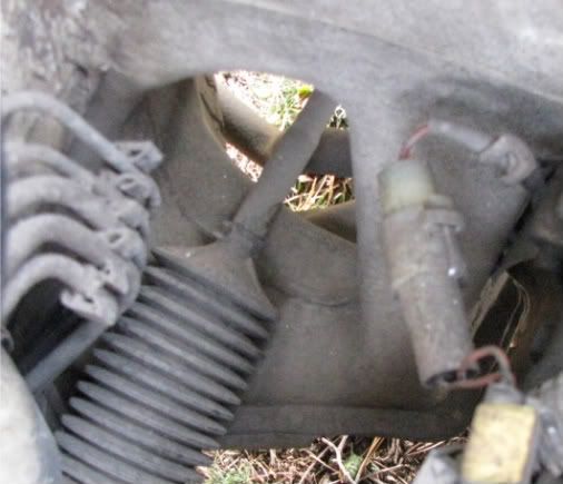

The frame looks free of rust.

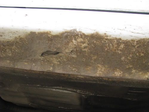

It was in good overall shape, some rust on the rocker panels, but looks good inside and out.

Now I just need to learn how to fix the rust in the rocker panels. :news
