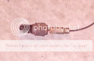

BTW, my car has started and run fine for a long time and I get 56 mpg. BUT the CEL would come on if it idled for more than 2-3 minutes. or if I coasted (engine on or off) for a mile or held a steady speed for more than 3-4 miles. an occasional 5oz of Seafoam in the tank would help. I attributed it to the street/race cam but it was in fact the O2 sensor. I replaced it today and the idle smoothed out. It was $17 for the one-wire Bosch sensor. A Denso sensor would take almost a week and cost 2x as much so I took a chance. Anti-seize worked great and it was easy to remove. Turns out it was broken.
