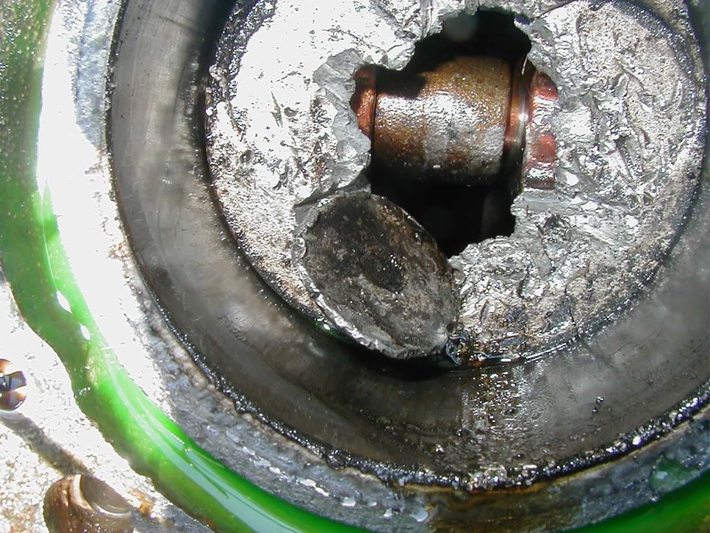

I get home, and check the timing belt. It looks like it's in place just fine. I try cranking the car again, this time the starter just clicks like it is trying to turn, but can't. Push car into driveway. Start to take apart engine. When I pulled the throttle body, this is what greeted me:
I am beginning to understand that something went terribly wrong...but what? Off comes the intake manifold:

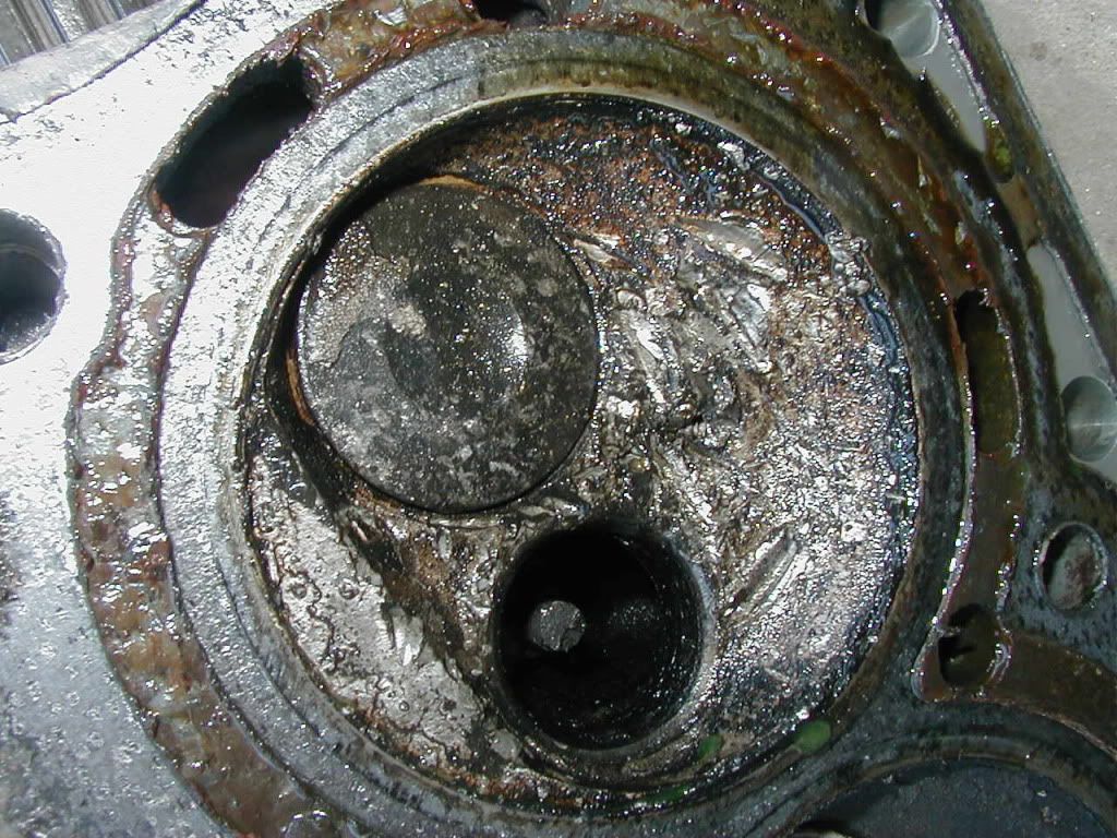

Well, at this point I was getting tired, depressed, skinned knuckles, my hand was still swollen from a wasp sting a couple days before, and other drama, so I stopped for the evening. Today I pulled the head, and saw the full carnage:
Yes, that's the head of the exhaust valve embedded in the top of the piston. Now for the head:
Soooo.....
Looks like the head and piston have a little bit more damage than I can fix with Bondo and JB Weld.
Stay Tuned....More To Come...
Edited by JoeBob, Sep 6 2011, 05:10 PM.
Id start talking to that machine shop if i were you, how old were those exaust valves? And what type did they use? It looks like your motor is going to be a total loss, if anything can be salvaged after that id be amazed.

OUCH! That is what you call catastrophic failure. :die

True. Time to source a new motor to rebuild! This time use some stainless steel valves (3Tech head package would be great if you can afford it).

also, i think that the type of failure you suffered is from a defective valve more than a deficiency of quality work from the machine shop. i've had brand new valves drop a face like that, punch the piston crown, and beat the tar out of the head on g10 and g13 engines.
honestly, when that happened to the wife's g13 grocery getter, i pulled a head and a piston assembly from an engine at pick and pull, shoved the piston into the engine from the top while it was still in the car and bolted the head back on with the old head gasket. she drove that car another year and sold it to a local guy who is still driving it 3 years later.

Take the block to a machine shop and see if they think it can be saved. The largest oversize available without buying something custom is .040" over. If you can squeak by with .020" that would be best as you will still have one rebuild left in the block in case something goes wrong again.
Toss the head, it's done.
