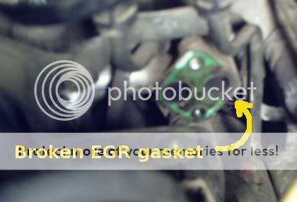

Edit: Come to think of it I just fixed a "knocking" only heard when the car was under load. I got a mechanic's stethoscope fro Harbor Freight and went poking around to see if I could find bad noises. Never touch the end to anything electrical or moving. The manifolds, block and valve cover (upper end) were OK and then I touched the EGR valve. :smackface It was knocking. It shouldn't do that. I got a new $1.50 gasket in anticipation of a major clog or failure. Took the EGR valve off and the gasket had blown maybe 1/2" out. New gasket and all is well.
