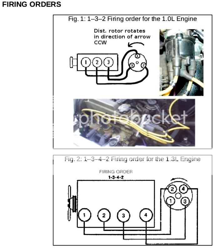

Okay here is the deal. The metro Ive been trying to get to run for the past month plus has thrown me a curve ball. I dont know if it would be something wrong or something I did. Lately I been under stress, and when the electric company decided to yank my power that put me over the edge (right now Im posting this from my wife's smartphone) Any ways I took the distributor off and adjusted the gap in the module in the. Now the car starts a bit but sounds like a freight train. Not only that but the thing is so hot afterwards its scary. Plus all the smoke is rough coming from the back. That has to be more then being out of time. Is it possible to put a distribs rotor shaft in the wrong way? How about the piece in the distrib? Could that setting have throw it off. Is it just acting up because its been unplugged for so long? Really need two cars so my wife can work, and I would be able to before another utility gets yanked. Thank you! |
| Bad Bent | Sep 19 2011, 12:21 AM Post #2 |
What kind of manual are you using to repair this car? What have you done to it? How many miles on the engine and has it been rebuilt or what? What were the original symptoms that caused you to get into the distributor? There is a module that says don not move in the distributor. Did you remove the plug wires? The firing order 1-3-2 and here is a picture: Firing Order Picture Did you leave an electrical connection or vacuum hose un-connected? Is there something rubbing in the dist and what exactly getting hot? Sorry about the electric. Edit: I deleted the double topic. Edited by Bad Bent, Sep 19 2011, 12:23 AM.

Thanks for the recap. Look at page 2-6 of the Chilton to see the offset pawl on the end of the distributor. Fairly hard to get it in wrong. Which is why I asked if the plug wires were in the correct order. 250K on the engine and have you done a compression test? Code 42, then click on: Test CKP and or CMP sensor and test your CaM shaft Position sensor. You could post a wanted and see if anyone has a distributor for your '96 that they would sell. If I had an engine stall then I would quickly pull the plugs to see if they were wet or dry. Wet; flooding, not firing. Dry; firing and maybe no fuel. Starting with pedal floored, then flooding and I'd look at the injector/pressure regulator. And with that many miles, compression. Air, fuel, spark, compression. But 245,000 and still running should give all of us hope.
