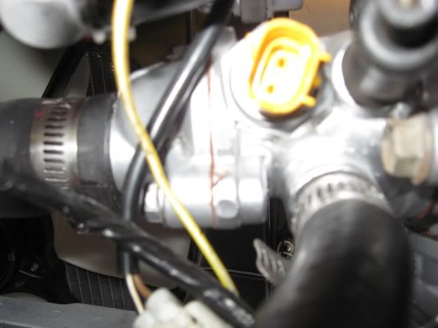

| snowfish | Sep 22 2011, 12:17 PM Post #10 |
Should be on the thermostat housing.![]() The Yellow plug is the fan switch. The one next to it is for the temp gauge. At least on a 91......................
| Memphis metro | Sep 22 2011, 12:22 PM Post #11 |
My 95 has a green connector on it. |
| mwellner4 | Sep 22 2011, 12:24 PM Post #12 |
mines blue... but am i just supposed to replace it? will autozone or someplace have it? |

| mwellner4 | Sep 22 2011, 12:36 PM Post #14 |
I already tested the fan... it was bad. Thats why I replaced it. Anyways so I unplugged the thermostat switch on the housing while the car was on and the fan started up. What do I need to replace? |
| Memphis metro | Sep 22 2011, 12:42 PM Post #15 |
If your temp guage shows the car to get to operating tempature then chances are good you need that sensor in your thermostat housing. |
