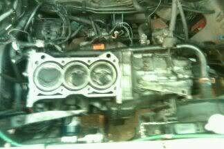

I pulled the head and found a piece of rubber hose used instead of the alignment dowels. The head bolts used either 14mm socket or 15mm sockets and the incorrect ones had been ground down to fit.
I am in the process of getting pics of this. Oh yeah. I almost forgot. I was wondering why so much blue smoke. Well the piston rings were all lined up with the gaps so neatly in a row. I am trying to the pics of this.

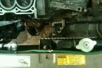

The radiator is zip-tied in place and the EGR passages were plugged with sludge. I dropped the pan and a cork gasket that had chuncks out of it that were filled with rtv to even it out.
The exhaust was welded to the manifold and there is a large glass pack in place of the convertor.

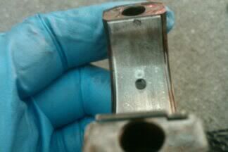

The rod bearings look as though water was in it at startup. And the babbit is flaking off. I pulled a main bearing cap and it don't look too good either. So I guess I have to pull the rest of the engine/trans....I believe it needs a clutch anyway.

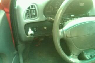

The first pic is the custom horn button and headlight switches due to a bad clockspring and headlight switch.
Second is the engine showing the zip-tied radiator and the wonderful green cable that now work the headlights.
You can see the rod bearingBut the last pic shows how good the car looks. Wish mine looked that good.
