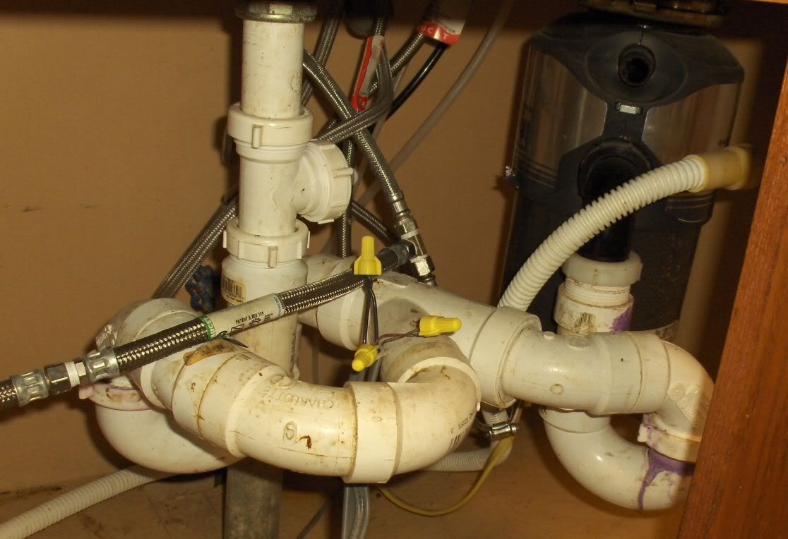

I know this is a little off topic, but this is a thread about plumbing and I wanted to share what was in the house under the kitchen sink when I moved in.
Edited by Tofuball, Oct 29 2011, 09:23 PM.
Thats a monster.

im diggin the wires with just a wire nut on....next to a leaking "Y"...looks safe to me.
Tofuball
Strange Mechanic
It's OK! It's grounded! ;)
