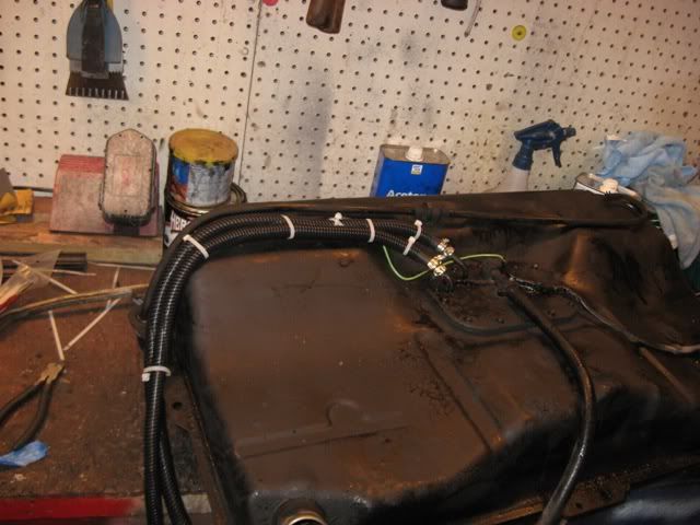

Hoses work fine. I double clamped at the tank.![]() And added split loom cable guard to better protect against abrasion. |
