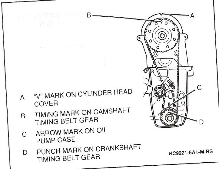

Welcome! Sounds like the timing belt is off a couple of teeth. Pull the cover and check to see if the timing marks line up. Just saw where you asked for a pic of the marks. Sorry, I missed that. If you've wrenched before, you can't miss them. I would check them as soon as you can, but don't worry. No matter what you read, a G10 is a NON-interference motor.

Welcome merlot566jka. When you put the new TB on don't mess with the throttle stop setting. If it still has the plastic cap on, leave it alone. It is only there to prevent the butterfly sticking closed. Has no bearing on butterfly position when running (or shouldn't). That is controlled by the ISC (idle speed controller) The Throttle position sensor setting and the Map sensor will affect the idle. Check vacuum lines. Next step is a compression test compression test Without a cat you will throw a code when the rear o2 sensor reads close to the same as the pre-cat sensor. +1 on checking the cam timing. ![]() |
| merlot566jka | Dec 7 2011, 11:50 AM Post #9 |
Engineer
I had only jacked with the throttle stop to aide the idle. I wouldnt leave it that way for sure. I will adjust the TPS when I re-install the cleaner TB The ISC is in addition to the IAC? I thought I saw two vacuum lines on the back side of the TB for an external IAC?? I am not too worried at the moment about the rear 02. I will make an RC time constant circuit or use an oscillator like the 555 timer to bypass the rear o2. Or maybe mount it further down the line from its stock position for the delay. Either way, a CEL for the rear o2 wont effect the running of the engine. Thanks for the pic, I wasnt sure on this motor, and I didnt want to phase it 180* out. Any other things to look out for to point to the rich condition? I remember seeing something about a coolant passage on the TB?? |
