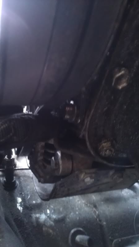

there is one bolt on the timing cover that sticks out far enough so it actually touches the alternator belt.
i borrowed a dremel from my neighbor and i was going to sand down the bolt enough so it doesn't touch the belt, but i wanted to know if that is a good or bad idea first.
i am pointing at the culprit bolt in this pic, it may be hard to see because of the black glove, but you should be able to see it.

I don't see that making a squeak, but you aren't gonna mess anything grinding it down a little.
allmountain40
The reason the belt is hitting the bolt is because someone put the wrong bolt in that hole. The timing cover has several different length bolts and if you put the wrong length bolt in the bottom it will bottom out and stick out far enough for your belt to rub. Been there, done that. Put the correct length bolt in rather than grind that one down. This should not cause the squeek, it'll only wear the edge of your belt down. However if it has been rubbing for a while, it will grind enough off of the BARELY adequate belt to allow it to slip and squeal. :thumb

I'd just toss the bolt out. Timing cover has ten or so of them, one won't make a difference.
