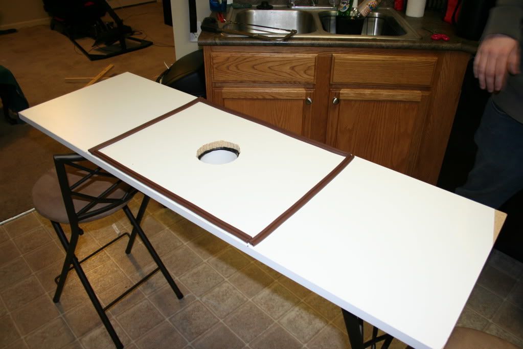

-Rebuild a vacuum chamber so we can vacuum form covers for the front of it.
-Make the form fitted covers

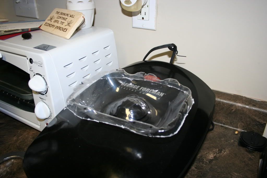

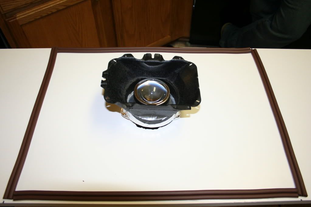

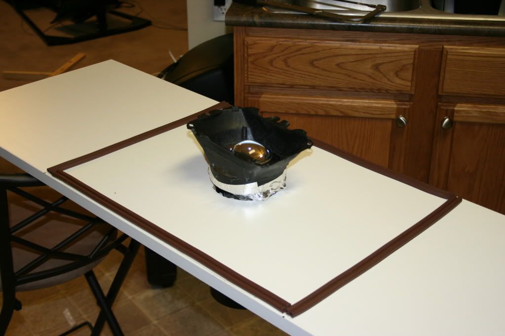

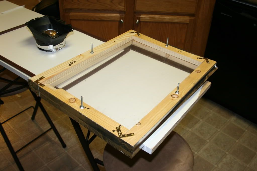

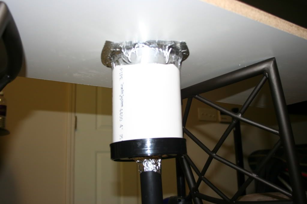

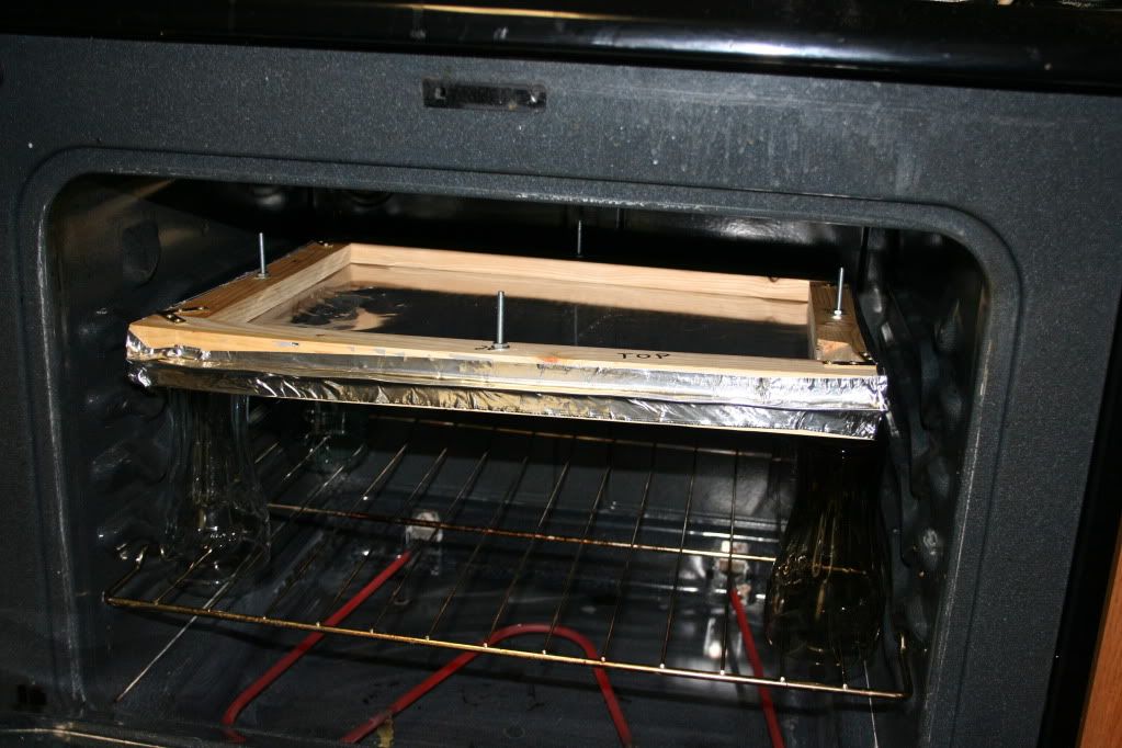

Here are some pics of the vacuum chamber we are making to allow us to make custom fitted shrouds. Hopefully will have the majority of this done tonight!

Update!!!
Beer bottles weren't working that well, so we switched to Coke glasses, lol
One to go! Then just painting, and trimming!

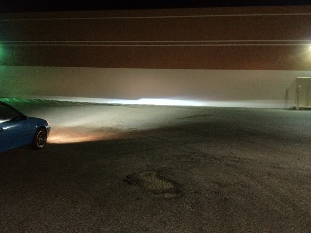

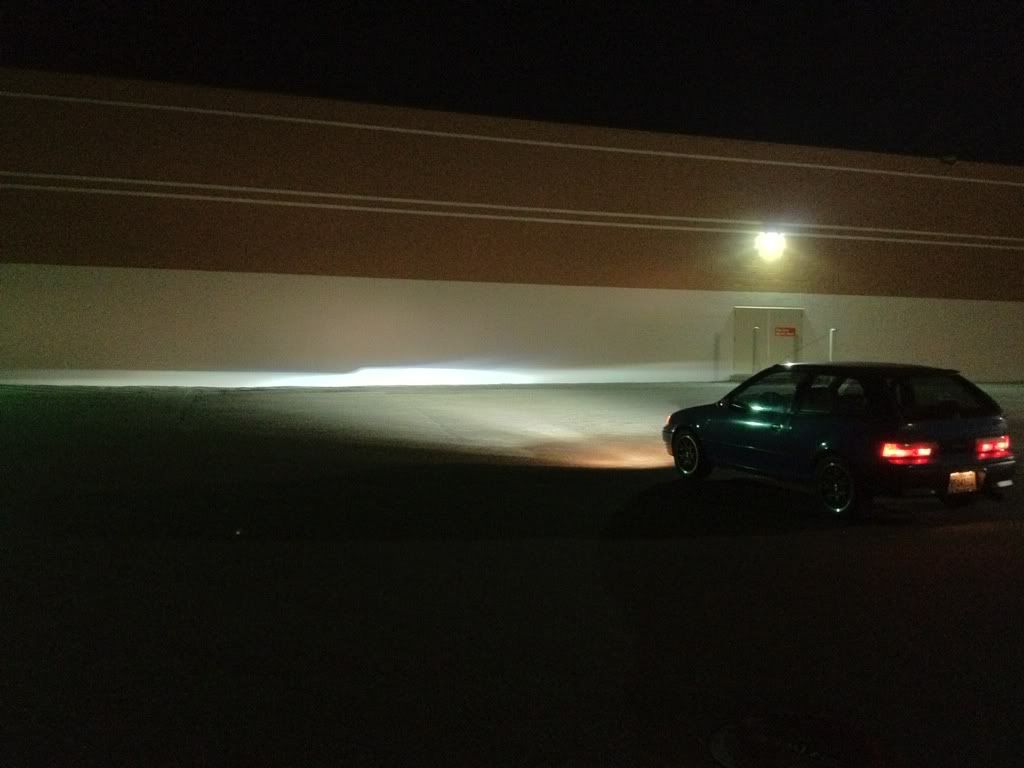

Guess it's about high-time to update this:
The lights are complete and in the car now. We are using a 4300k Philips bulb (has shifted to 5k). MUCH MUCH MUCH better output than the BMW Projectors!
Compare for yourselves!
BMW Projector:
New TSX Projector:
Thoughts???
