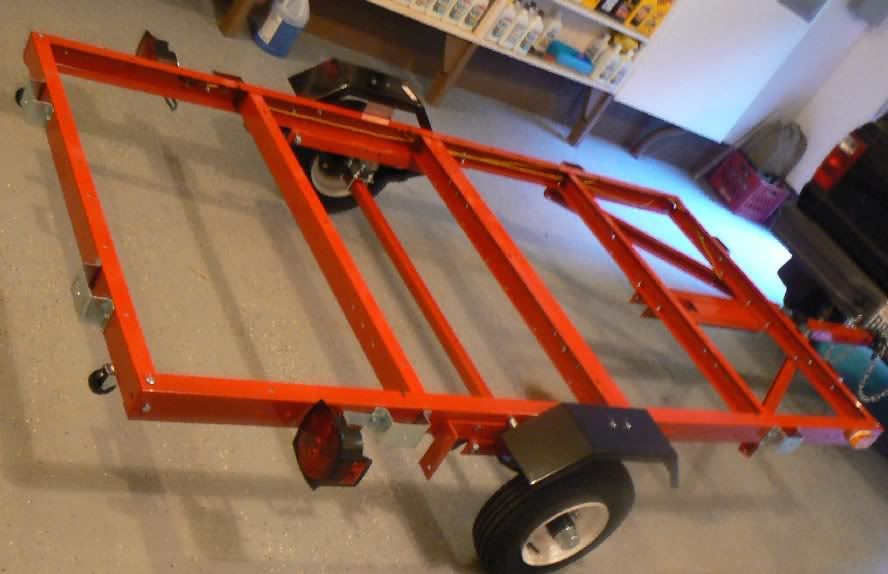

considered it. bought a new trailer rolling stock kit from Fred Meyer
(Krogers in your area) for $120. Its weight is 199 pounds, figured
another couple hundred pounds of aluminum skin and another couple
hundred pounds of kitchen and bed stuff and I should have a 600
pound camper for two people that my Metro would be happy with.----
rolling frame is together: Pic,---
Very neat looking trailer. Makes me want to start building them again.

couldnt turn down the $120 new price, :drool even tho it came in pieces
in a cardboard box with chinese writing all over it. :shake :smackface
lol, itll work pretty good, just watch the corners, i had a Boxed boat trailer, and the corners that they crease had actually spilt. Oh and Buddy Bearings, are awsome :D

:shake guess I gotta do full disclosure. I have to start all over
again. :hmm wife hijacked my frame :smackface and made a
trailer for her riding lawnmower. :banghead :banghead :banghead
