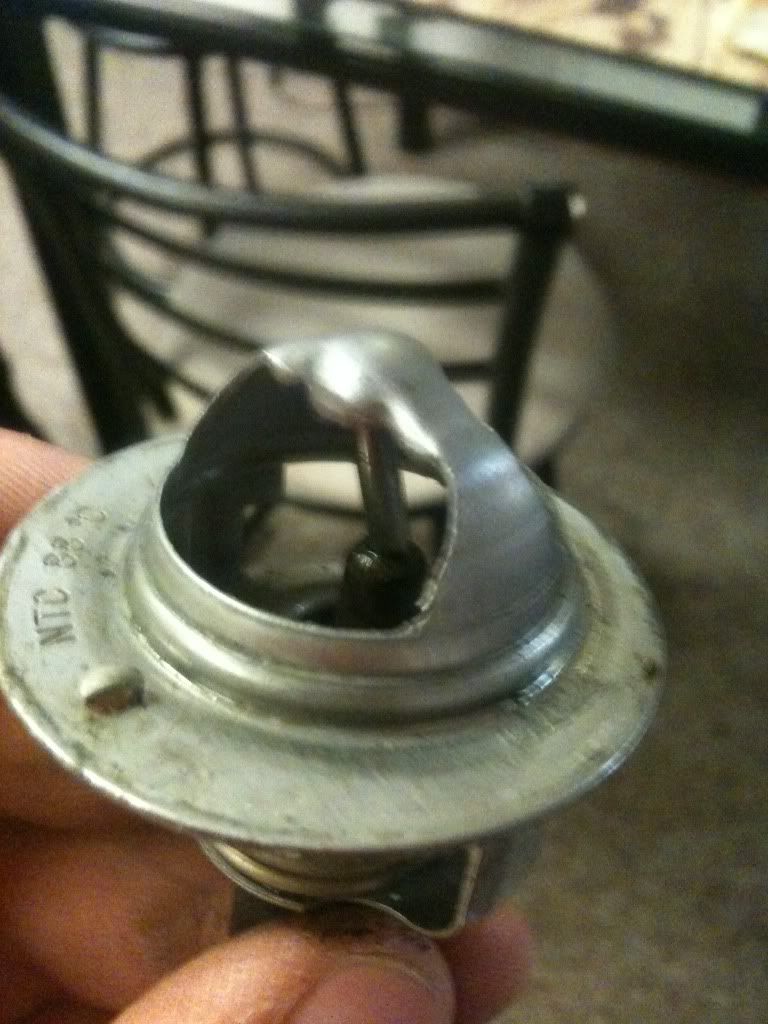

Alright I found my heat problem: ![]() So obviously I fixed that. As for the crank/cam seals I'll have to wait until I get a couple days off to work on them. Thanks everyone! |

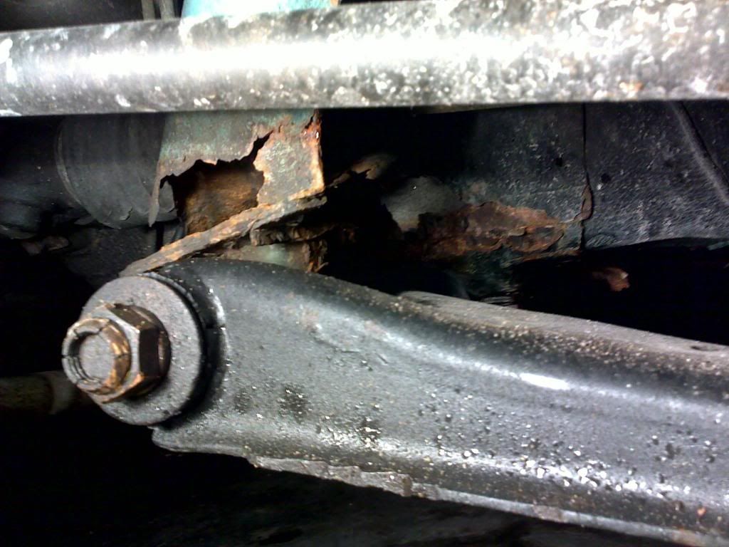

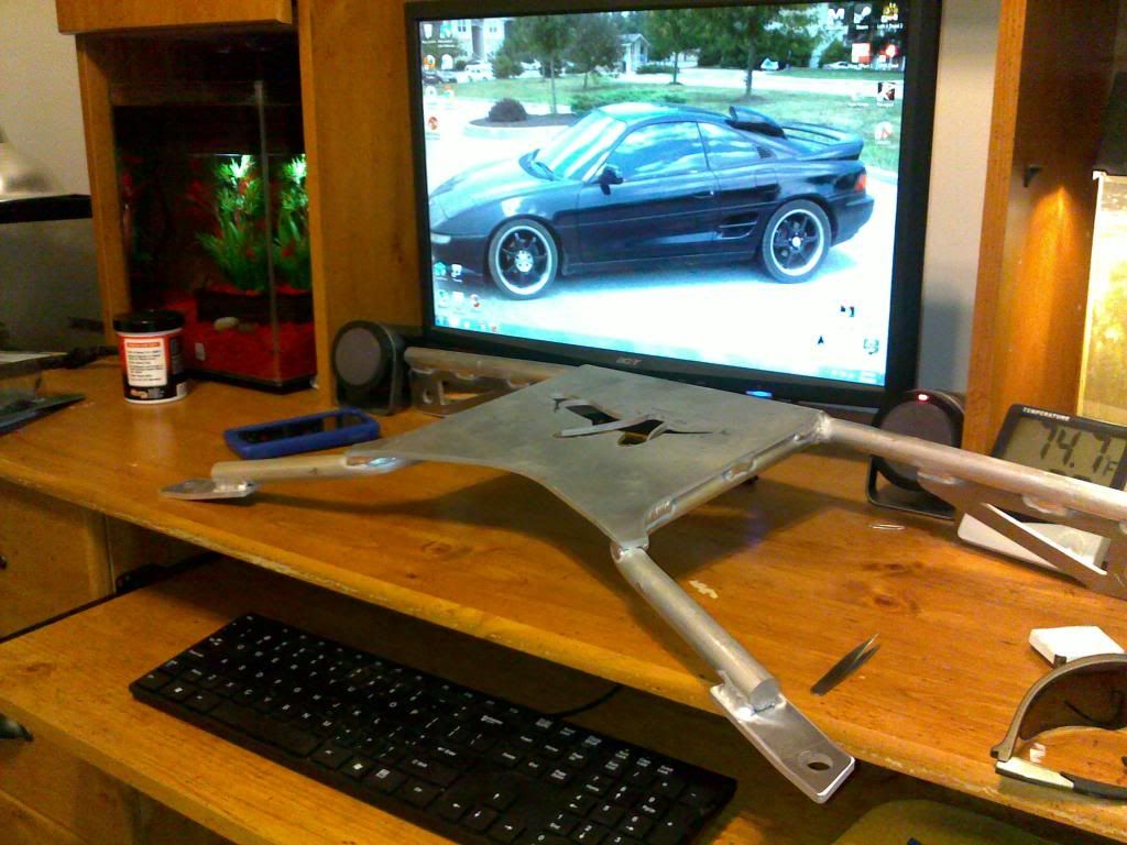

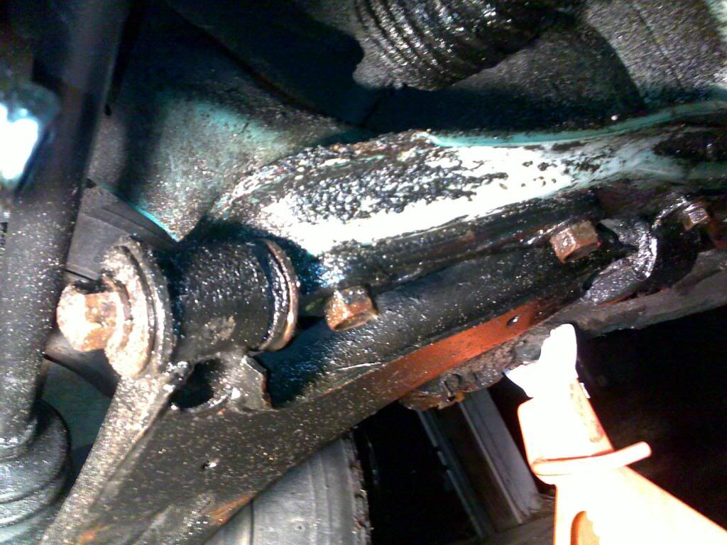

Well I ended up rebuilding the engine in this car a couple of months back. It ran so much better than it ever had. Then about 3 weeks later I hit the brakes too hard and broke my frame. I bought a frame brace from 3Tech. I couldn't get the bolt in the frame brace on the rear on the drivers side so I'm taking it to a shop tomorrow. ![]() This is what I was working with. Drivers side: ![]() Passenger side:

Holy SHIT..............![]() |

Another frame horn fix thread ![]() Let's see what the shop does

"...it's a 1.0 liter 5 speed and it has a couple of problems". (looks like you found the biggest problem!) Ya'll need to come south and buy a rust free Metro before they're all gone.

first off pull out the tube that comes from the evap canister, the factory installed it into the frame on the drivers side, look and you'll see it, right into the frame at the top of the frame horn., it is pumping sulfuric acid fumes from the gas tank vapors. when the canister charcoal fails and becomes saturated it just pumps it right through into your frame LOVELY huh? what a factory screw up. i had my metal tested and it immediatly showed sulfureric acid i know a metalurgist he's a friend of mine from way back, we did it for research. i didnt tell him where the metal came from until after he gave me the results. second install a new PCV valve, i did and mine stopped leaking. try it before all the work huh? crank case builds up pressure and pushes out the weakest spot, the front crank seal. trying to help ron Edited by RONNIEREDLINE, Mar 7 2013, 09:50 PM.

It's just going to the shop for the bolt. There is a guy on here from Indianapolis that does frame fixes and I'm going to try to get in touch with him and have him do it. It's funny how one side looks almost perfect and the other side is completely gone. But honestly after using a come along to get the frame back into somewhat spec it drives a lot better. I drove it 45 miles with the frame busted up like that.
