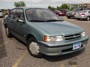

As you know I sold my Geo recently and have been on the hunt for a similar or close mpg buy...
This is what I came upon...
Picked her up for $300 with 65k miles, very clean in and out, still have that new car smell... mmmmh nice.
It had thrown a con rod and caused two holes in the engine block, yikes!
A reported potential 40mpg or more... we will see...
Already lined up a long block to replace the original, which has 120k miles that test out ok,
but some new parts are likely.. eg: timing belt, water pump, etc.
Will post future updates.

Oh my bad, sorry... It's a 94 Toyota Tercel, 1.5SHC, with 12valve single cam.
I have concluded that this particular motor have weak internals, mostly connecting rods.
They are very narrow at the neck where it meets the piston.
I know of at least half a dozen previous Tercel owners who have had similar issues, but at this price it was too hard to past.

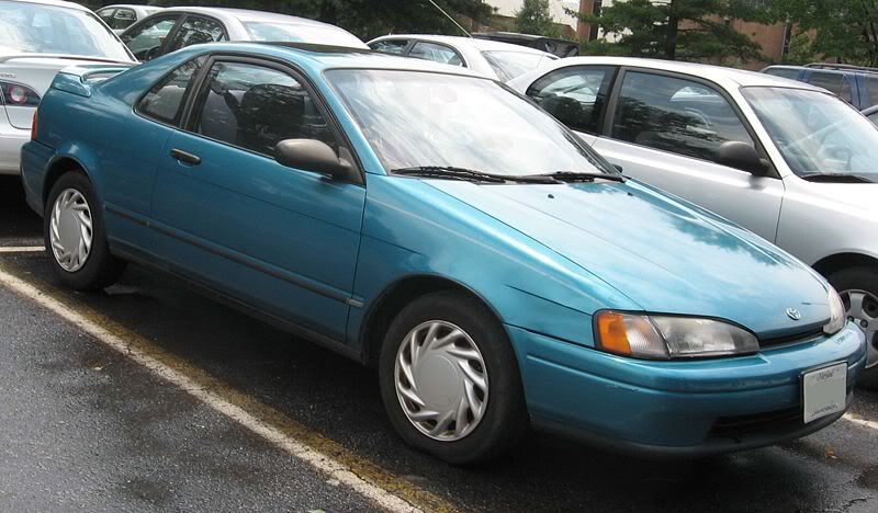

A replacement motor with stronger internals is the Toyota Paseo; 1.5DHC, twin cam 16valve... Seen here.
Reputed 100hp with average mpg 40+
(which I pick up today)
Edited by TheKid, Jan 14 2012, 04:03 PM.

Long block was $300, 200psi on all four. Comes with a steering pump, etc but will used the original since it's got lower miles.
Well, I wish you the best with all that, but from what I'm reading the mileage on the Paseo doesn't read anywhere near 40, even optimistically.
1994 Toyota Paseo 1.5 L, 4 cyl, Manual 5-spd, Regular Gasoline - 24 City / 27 Combined / 31 Highway
Or maybe I am misreading what you wrote, and your saying that engine tied to your Tercel's tranny will do 40 mpg :dunno but that would also appear optimistic according to the government (you didn't mention 4 or 5 spd, but it is 2 mpg difference either road) :
1994 Toyota Tercel 1.5 L, 4 cyl, Manual 5-spd, Regular Gasoline - 24 City / 27 Combined / 31 Highway
Either way, good luck with it, I hope it all works out for you :thumb
