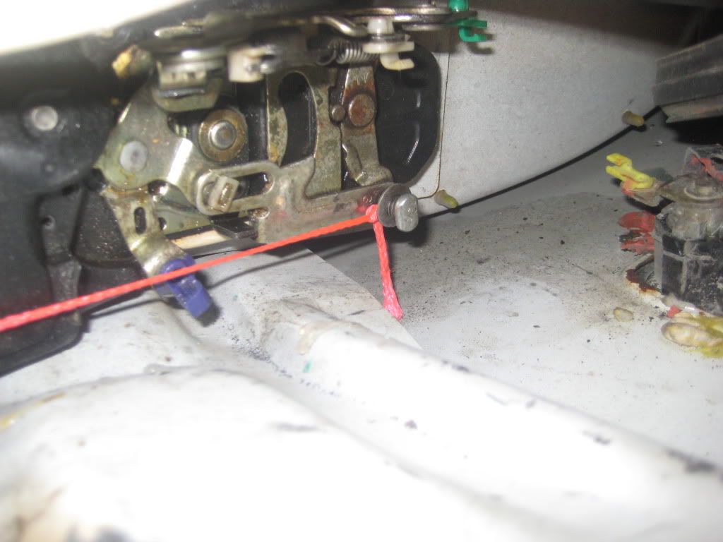

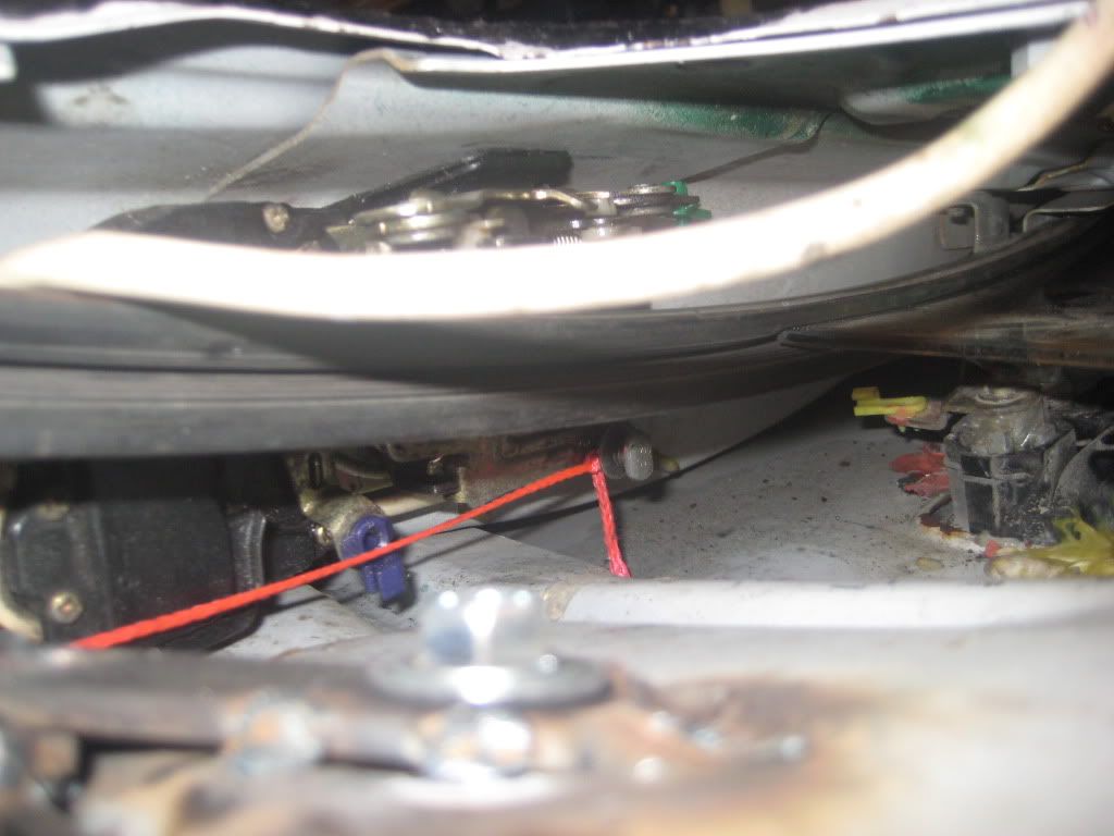

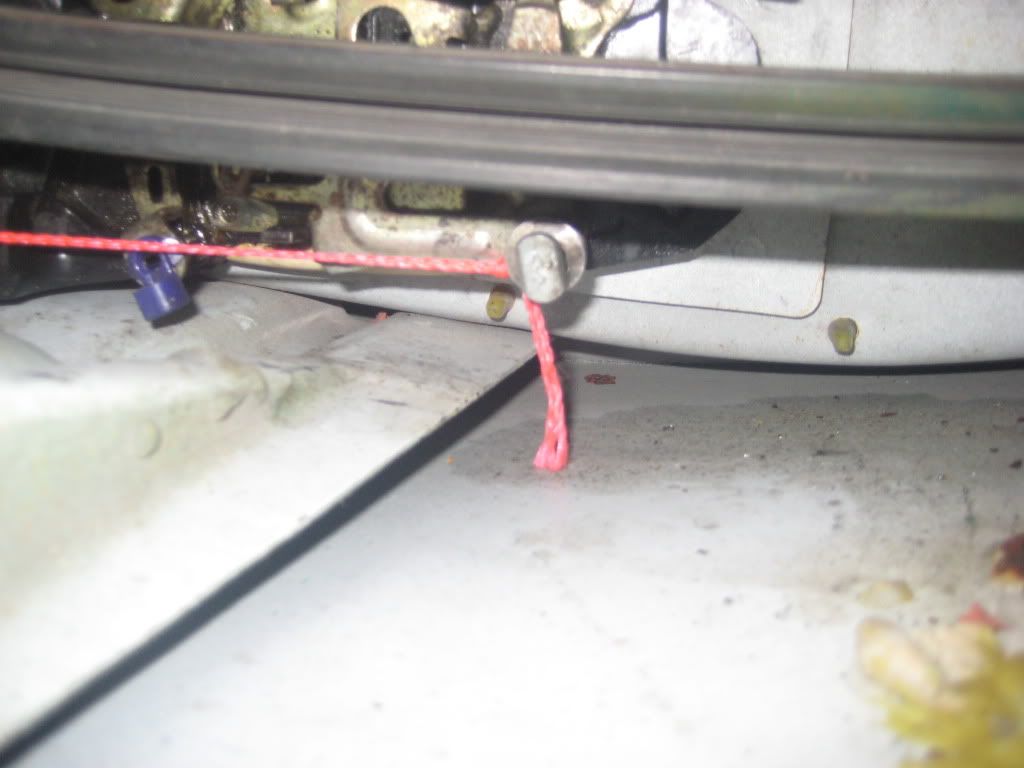

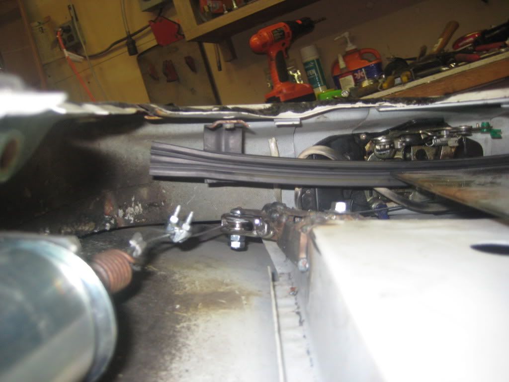

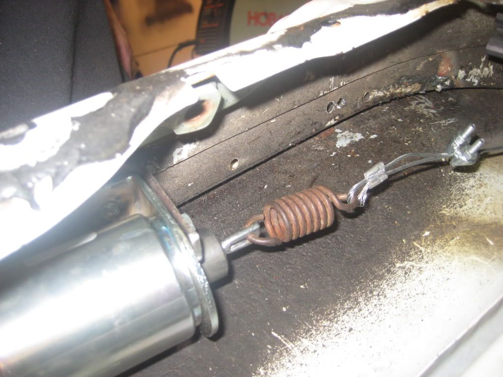

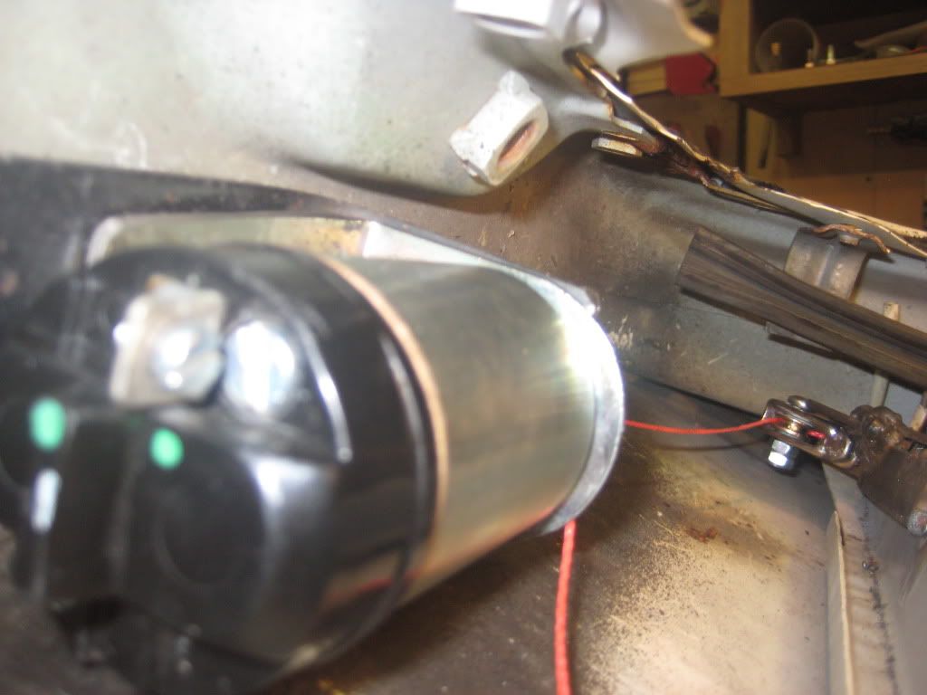

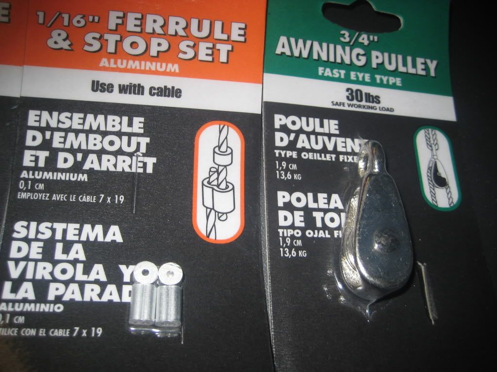

I started with a 50 lb solenoid, cable, pulley, 75 lb door popper, welder and patients.

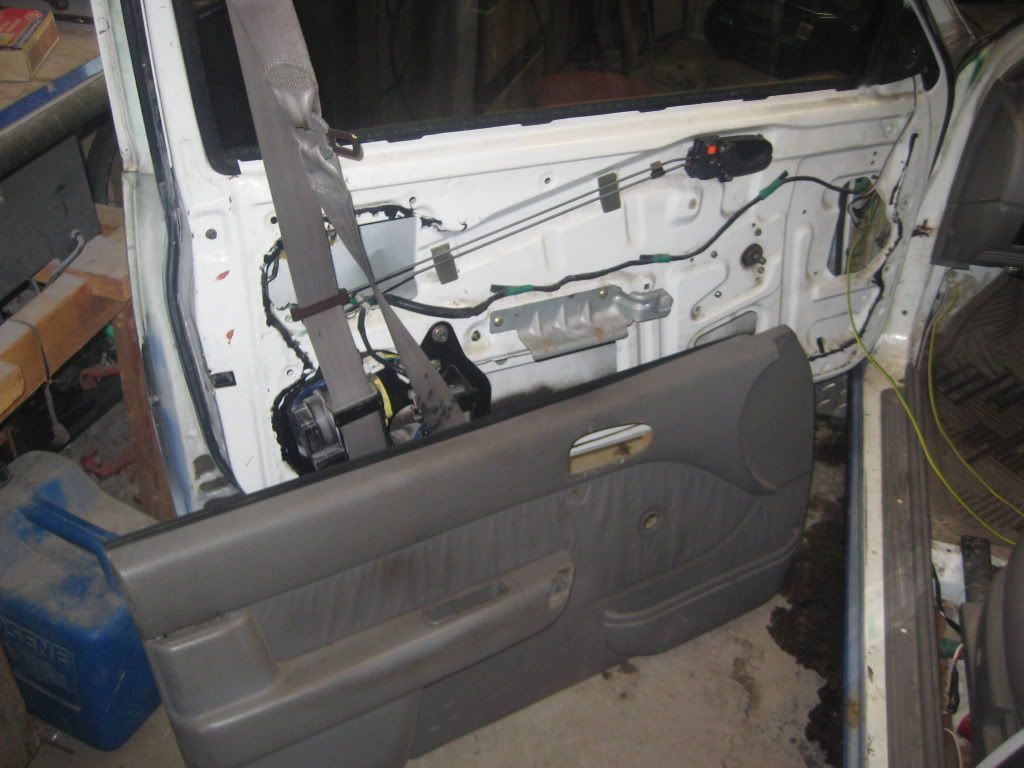

I removed the door panel ...
Lifted the door off the car with a engine lift ... and mounted the solenoid horizontal on the bottom of the door.
I wired the solenoid to a relay directly to my battery with a 40 amp fuse. I installed a secret remote switch to open the door.

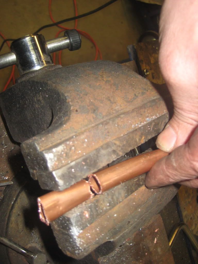

This is my home made wire connector 'to-be'

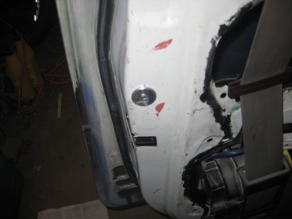

These show the spring loaded poppers in the door jam.
http://s1193.photobucket.com/albums/aa341/dahhmann22/Project%20door%20opener/?action=view&current=MVI_2324.mp4 or here is the brief you tube video ...
I still need to put the trim back on the door.
In all, the door closes without much effort. It opens without an troubles. Investment: $40 for the solenoid. $30 for the door popper. $30 misc ...
I hope the pictures are displayed properly.
