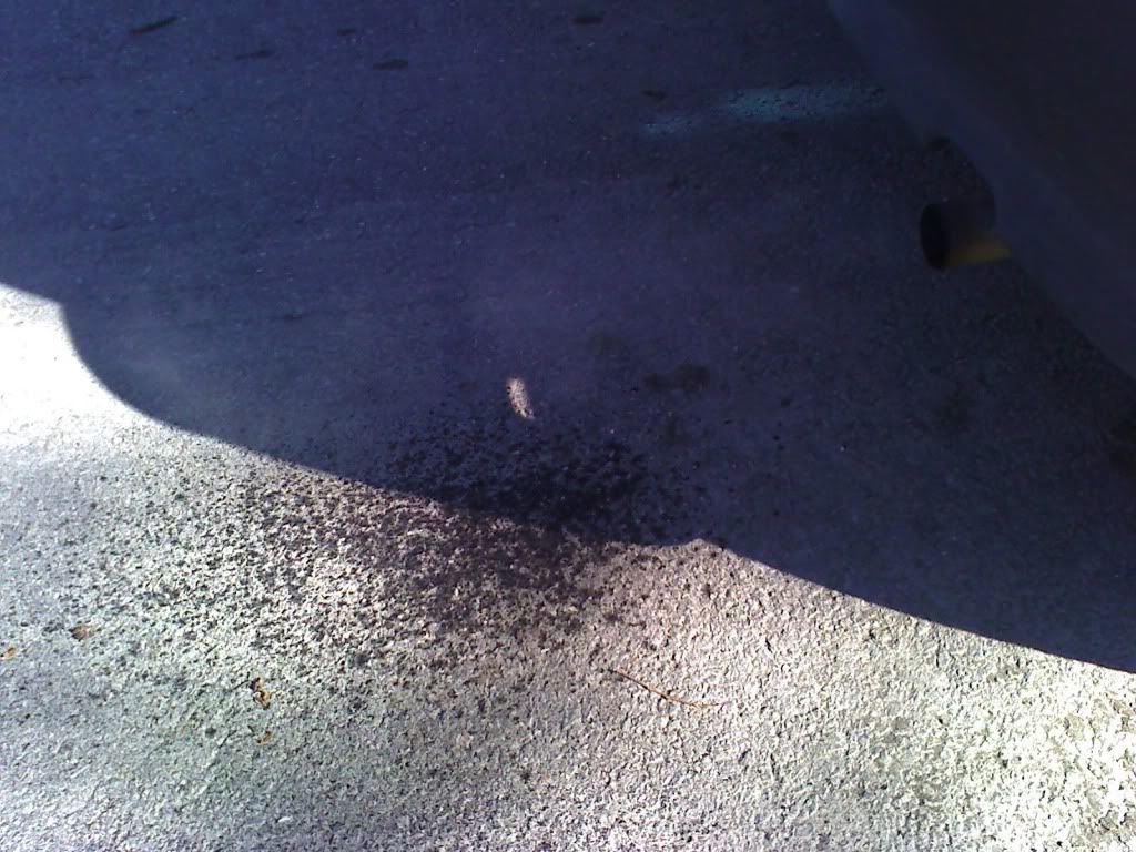

My beloved G10 is losing oil. I lose about a quart after an hour's drive. Other than that, the engine runs fine. I've recently replaced a few gaskets to address an external oil leak. I replaced (in this order): the cylinder head gasket cam cover gasket exhaust header gasket intake manifold gasket oil pan gasket oil pump gasket (crank seal on pump side) ...and then I realized it just needed a cam seal on the timing side to stop the leak. Now that I've thrown $100 in gaskets to fix a $3 seal problem, my engine is losing oil out of the exhaust. I don't understand how that would be possible unless it's leaking past the piston rings, right? Doesn't the oil on 4-strokes reside below the piston? If you don't already know, I normally work on 2-strokes where it's perfectly normal to blow thick clouds of oily smoke out of the exhaust. Everything went together fine when I rebuilt it but I do have some concerns. I originally messed up the timing and tried to crank the engine (unsuccessfully). Could that have damaged the valves from crashing into the piston or something? I cleaned the piston tops with some scotchbrite and blew the carbon crap off with an air hose. Could the scrubbing motion have damaged the piston rings? Lastly, the oil coming out of the exhaust looks kinda watery. There was no scientific test involved in that - just me rubbing it with my fingers so I could be wrong. Here is a picture of all the oil that came out after a two minute engine warm up. ![]() Any advice is appreciated as my GF will be really pissed if I spend days in the garage without knowing what the problem is beforehand. |

Back again. Dismantled engine for 3rd time this month and still leaking oil! I did a compression check. 130, 115, and 110 psi for cylinders 1, 2, and 3, respectively. I know they're supposed to be even but anything over 100 sounds like compression is still good to me so it shouldn't be leaking past the pistons. Upon dismantling the engine, I noticed only cylinder 1 was burnt while cylinders 2 and 3 were still shiny. I had thoroughly cleaned the piston crowns when the engine was last apart only a few hours of runtime earlier. So, cylinder 1 was the focus of my attention. I removed the old valve seals and installed the new ones. First set was hard to seat so I gently tapped it with a small hammer and socket extension. I completely smashed the little spring on the top. 2nd set of seals I just pushed down with my finger until they wouldn't go any more. I didn't get a popping sound or anything that would confirm they're seated but they seemed pretty snug. Started my engine and still leaking oil out the exhaust. Thinking that maybe the seals weren't completely seated, I tore down the engine again and put on a 3rd new set of valve seals as hard as I could press them in with my fingers. Still no indication of if they're seated. Still have an oil leak. I know that it could also possibly be cylinder 2 or 3 but I was out of new valve seals and getting the valve retaining semi-circle thingies back in was a bitch and a half. And wouldn't the burnt, oily piston indicate that it's the one with the oil leak? I know I shouldn't really re-use gaskets but I did with the cylinder head gasket since it's new as of the first teardown. Seems like it's still in good shape. Could that possibly be the cause or maybe the head became warped when I reassembled it? I would really like to know what's the proper procedure for torquing the cylinder head bolts as it doesn't say in my service manual. I guess it's off to the auto parts store for a new round of valve seals (for every cylinder this time) but I wanted you guys' thoughts before I go for teardown #4. EDIT - Just reread the "how to compression test" thread and it looks like I did the test wrong. I will redo test in the morning and see if I get different numbers. Edited by killerofangels, Feb 28 2012, 02:19 AM.

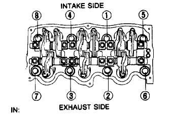

Bring them up so spec slowly, a little at a time, starting in the middle, like this............... ![]() Take about a half dozen steps to bring them to spec. This is a generic image, but should give you the idea. Principal is the same for cars, boats, snowmobiles, etc. |
| Coche Blanco | Feb 28 2012, 11:46 AM Post #15 |
I always do: 5 1 3 7 6 4 2 8 EDIT: (credit to rcmemeleleme for the picture) Edited by Coche Blanco, Feb 28 2012, 11:47 AM.
