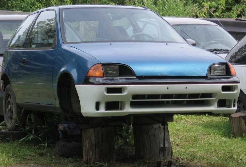

I have plenty of pics! I'll try to condense nine years of playing with Metros/Swifts into one post! I'll start with the blue MPH Metro, since I got it first, way back in 2003. It was originally an automatic, but I swapped it over to manual. Had a burned valve when I got it. It will be getting a GTi engine, possibly turbocharged too. Also getting a 4.39 trans, GTi bumpers and GTi front seats. And various other things like weight reduction and suspension mods. It's been off the road for half its life, so the rust isn't too bad for a NY car. And it was free!
Currently is sitting like this.

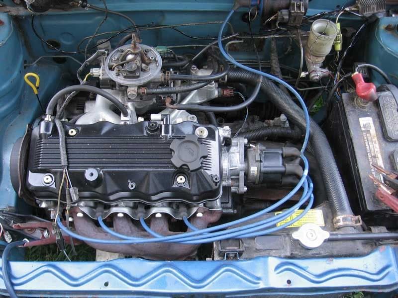

I had originally swapped out the 3-cyl for a '92 8-valve Swift engine and 3.52 manual trans. Never ran right, so I pulled it out when I got a GTi parts car.

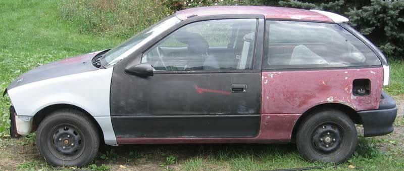

The black MPG Metro is a Florida car, so it doesn't have the NY rust I'm used to. It has working A/C! It will get some aero mods, 3.52 trans, GTi dash, Swift sedan seats, some suspension mods and some weight reduction. Yeah, I like light cars that handle good. :D
This is how it looked when I bought it for $150. Flat black with a Pontiac Grand Am wing bolted to the hatch. Looked like isht. It was originally maroon.

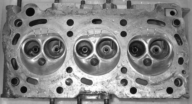

The original engine ran, but smoked really bad. I was going to rebuild it, then I found an XFi engine for $100. Not knowing the condition of the XFi engine, I tore it down. I was happy to find out it really was a XFi engine with two-ring pistons and the XFi camshaft. I am going to reuse the "gapless" compression rings, since I can't find a source for new ones. It's getting new NPR oil rings. I cleaned up the ports a little with a die grinder for increased flow. No change in size or shape.
I added Singh grooves, since I hear a lot of positive things about them:
I need to get the engine back together. Still have to hone the cylinders and get the head shaved down for higher compression.

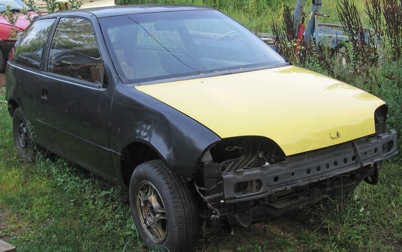

I also have a bunch of parts cars stacked to the ceilings with spares....

Never seen anyone spend time swapping in the 8 valve. It looks cool in there.
I needed an engine and just happened to find the '92 Swift. I parked them side-by-side and moved all the 8-valve and manual trans stuff over. I was adding 15 HP and two more gears. Part of why it looks cool is I tossed the steel valve cover in favor of the 95-97 aluminum valve cover. The DOHC will look even cooler in there! :D
