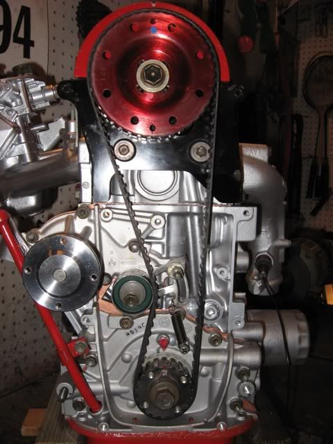

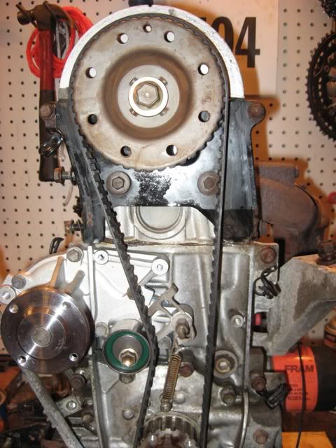

Crank sprocket has a little dot, with an arrow pointing at it on the oil pump. The arrow is hiding behind the tensioner spring.![]() Cam sprocket has a scribe line to align with the valve cover notch. Here one with the 3Tech cam sprocket. ![]() This time the 3Tech cam sprocket dot aligns with the valve cover notch. Also you can better see the hiding crank alignment arrow here. If those are lined up, you should be OK. Always rotate, by hand, at least 2 full revolutions to double check.

Thanks. I'm an idiot! Dowel pin on cam was supposed to be at6 o'clock. Not odd hole on cam sprocket. I hop I haven't done any major damage. Well I qusse I will tare into it tommorow. Thanks for the help. Just another rookie mistake.
