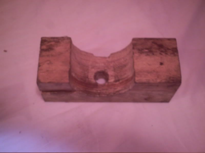

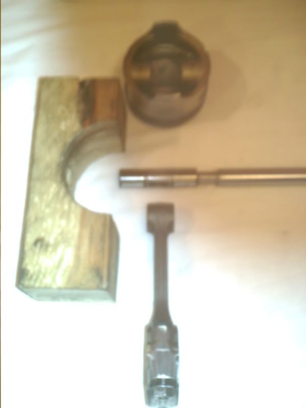

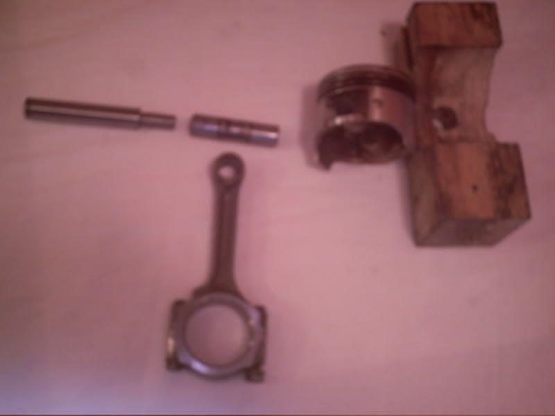

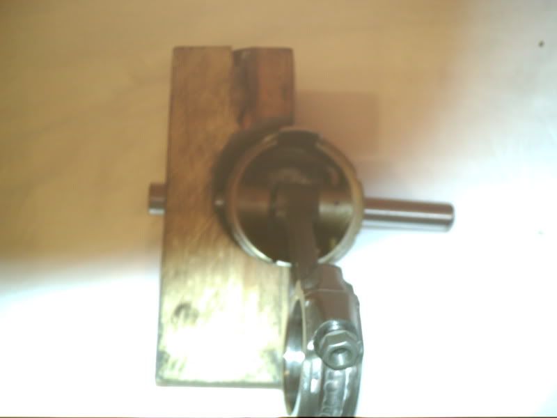

You need to use a press to press the wrist pins out of the connecting rods. I made a wooden block with a half round cutout like a saddle for the piston to sit in when pushing out the pin. Drill a hole in the saddle so you can push the wrist pin through it. I then made a pusher pin that has a smaller section that fits inside the wrist pin to keep it straight and a slightly larger section a little smaller than the outside diameter of the wrist pin to push it out. The wrist pin is 17mm od. You may be able to use this setup to push them out in a big vise but I use a hydraulic press. You can use the same pieces to press the new wristpins in but great care must be exercised to get them straight before you press them or you can destroy a piston easily. I have a guide pin to make sure they start in the wristpin dead straight but it is not here right now. Also be careful to get the wristpin centered when you press it back together. Sorry my dig cam sucks but it's what I have. ![]() ![]() ![]()
| bansheetaz | Apr 19 2012, 07:52 PM Post #9 |
its best to do this with a rod heater. atleast putting them back on the new pistons. less chance of warping the new pistons. |
