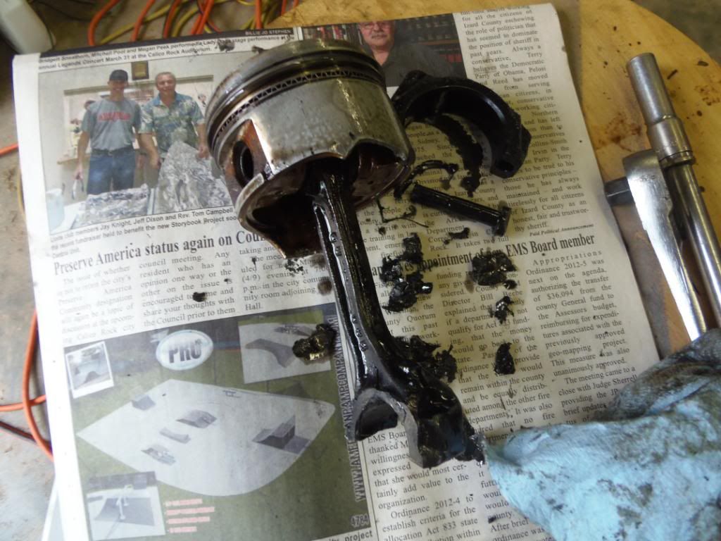

Better find out quick before it looks like this :D More here at This link. Click ME!
LMAO I had a Kawasaki 750 engine do that to me...All I had left was the head everything else was scrap metal. FYI never buy from SBT haha
Do you see the bolt in this pic? What has happened is that the nut which tightens that bolt has fallen off, thus the rod connecting cap is loose which makes the rod slap on the crankshaft. Your engine is dying a slow death. I recommend you do not start your engine any more because you will only continue damage the internals of you block. Pull the oil pan off and inspect the connecting rod nuts. Maybe you can salvage a bad situation by reinstalling the nut that has fallen off. That is the "best" scenario. The worst scenario is that you will need an entire bottom end rehab. :(
