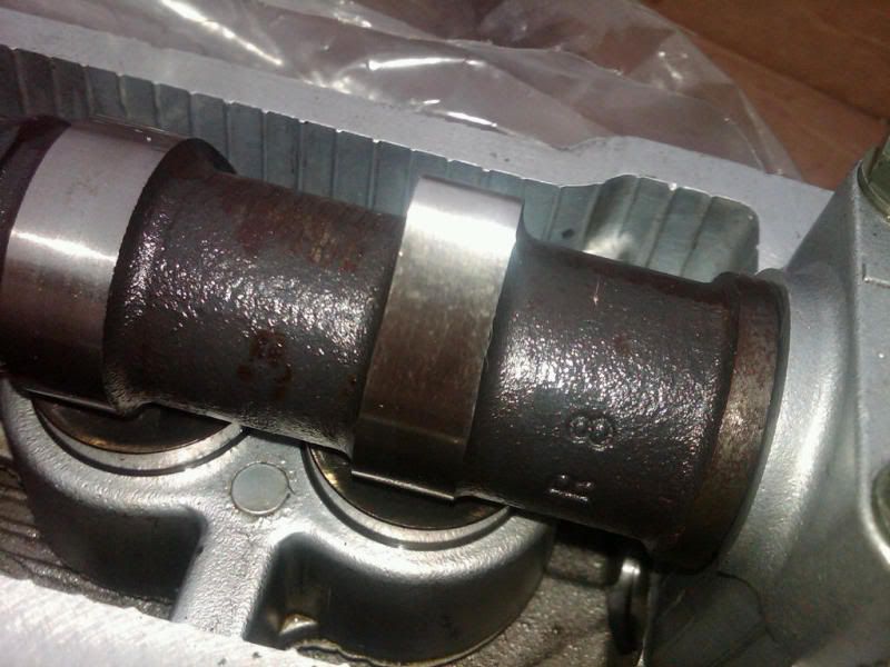

...its a completly rebuilt one but the cam lobes have some slight surface rust...would this ruin the caom or would a light scuffing with some emory cloth fix? there isnt any pitting yet just surface rust |

I'd contact the seller, unless you caused the rust? |
| ebayollis | Apr 30 2012, 07:51 AM Post #3 |
it was on it when i bought it...i got a good deal on the whole setup but if it is a problem i can just swap out my existing cam and use it but im just wondering if some emory cloth would hurt the lobe? |
| ronco | Apr 30 2012, 08:14 AM Post #4 |
I would try some scotch brite with automatic trans fluid, I think emery cloth would be to course. |

Pictures would really help. Any rusted internals makes me nervous.

heres a pic...its only on the one lobe pictured...ill try some scotchbrite pads..if i screw it up i have my existing cam i cam swap into it...i think itll be ok though, but i was wrong one time...lol

I personally would not run that cam. Rust seems pretty deep, but hard to be 100% sure from just pictures. Question is, was it left out in the rain with the valve cover off? I'd pull the cam & lifters and see what else is down there.

it looks like its just a fingerprint rust spot...ill scotchbrite it and then post the pics to see if it is in fact deeper than it appears |

do not use scotchbrite while the cam is installed in the cyl head remove the cam and use a wire wheel , if when you are done polishing you can feel any scratches with your fingernail do not use that cam get a economy cam from 3tech and send that tent stake in as a core assuming it is reusable as a core or reuse your old cam |

A wire wheel? I don't think that's a good idea. |

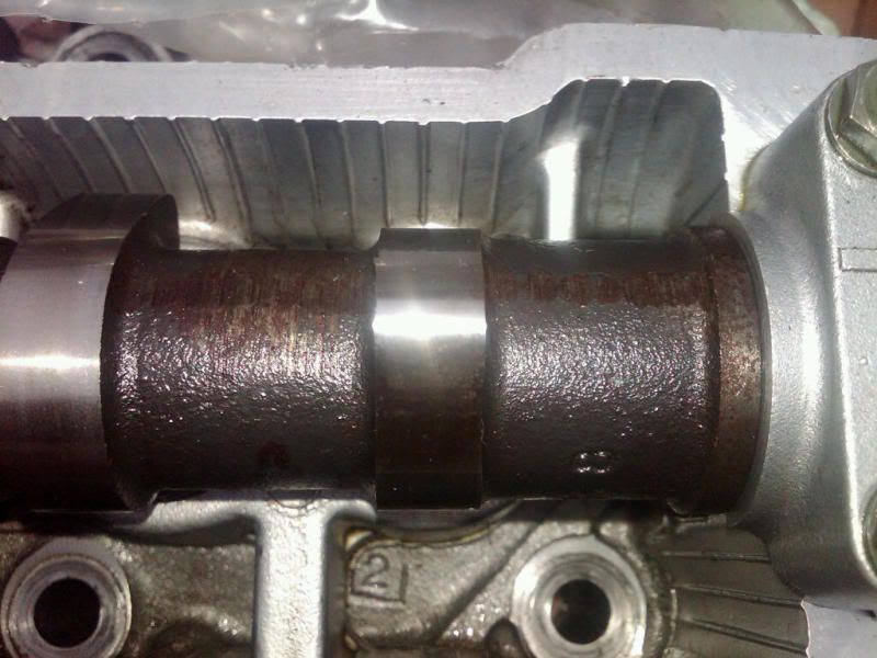

I got the rust off with about 3 scrubs of a stochbrite pad...ill post pics this evening |
| ebayollis | May 1 2012, 03:52 PM Post #14 |
here are the rust free pics!![]()
