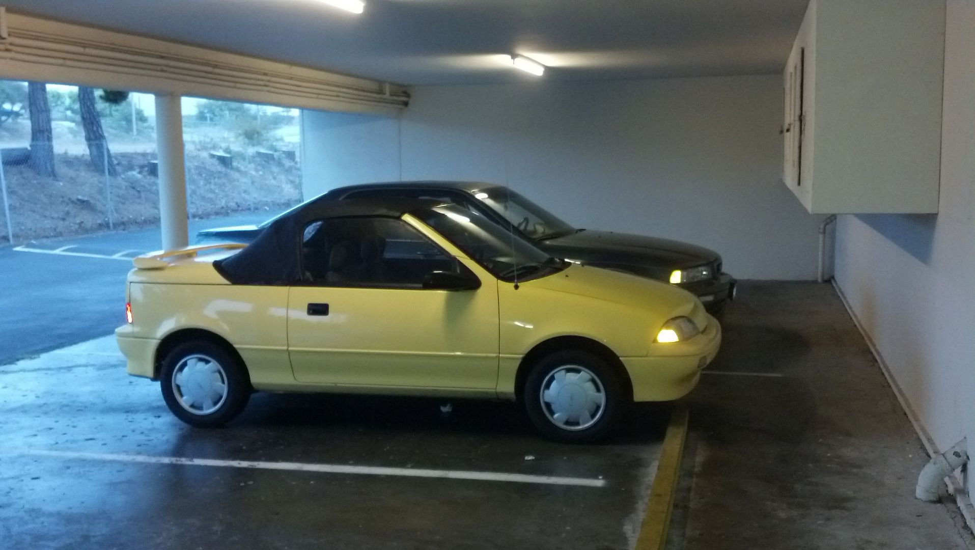

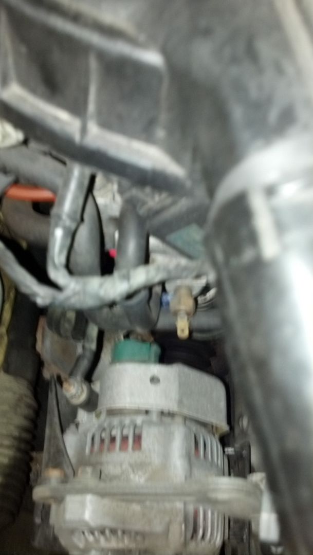

Hello! Just picked up a very clean 91 geo metro lsi convertible for a bargain of 900 dollars. Its a bday/grad gift for my girlfriend (kocampo). Car has been serviced at the shop i work at for many years and is in excellent condition. The previous owner had complaint of high oil consumption of about a quart a week. She wasnt interested of keeping it any longer as she had a brand new miata. Plan is to rebuild the engine with my lady if oil consumption is true. I did find a clogged pcv valve which i flushed in a bottle of nail polish remover for the time being. Fingers crossed. Only complaint is a tiny hole in the exhaust after the cat, and soft shocks. I did find a disconnected sensor on the passenger side of the intake manifold, IAT?Mike ![]()

Welcome to your new forum, mecevans! "New" Miatas, we get that a lot around here lately. Nail polish remover, that's new. For oil consumption check the compression; http://geometroforum.com/topic/2574993/1/ Disconnected sensor in the picture is for Air Conditioning. Mine's red. Monterey Bay... convertible.... forget about it. Thanks for the pictures. Very pretty car.

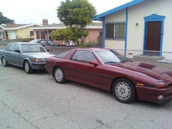

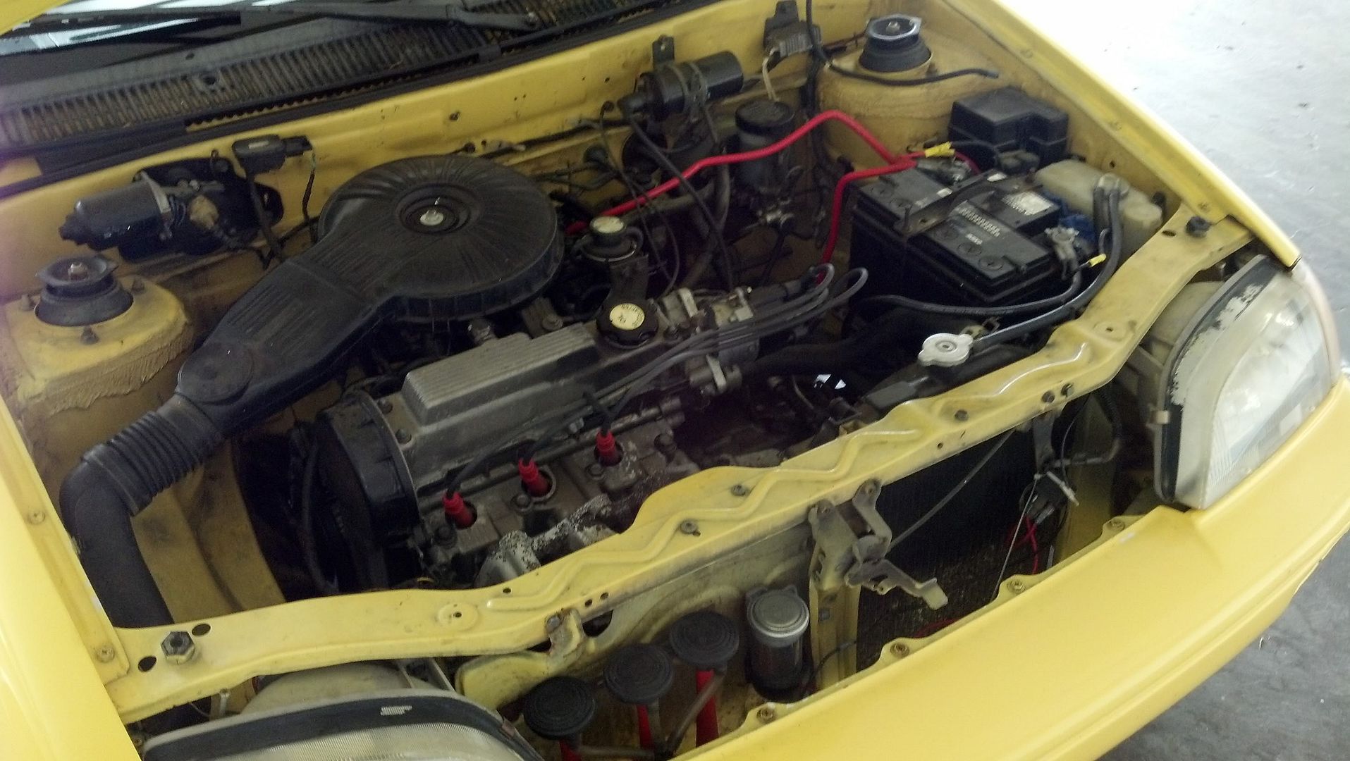

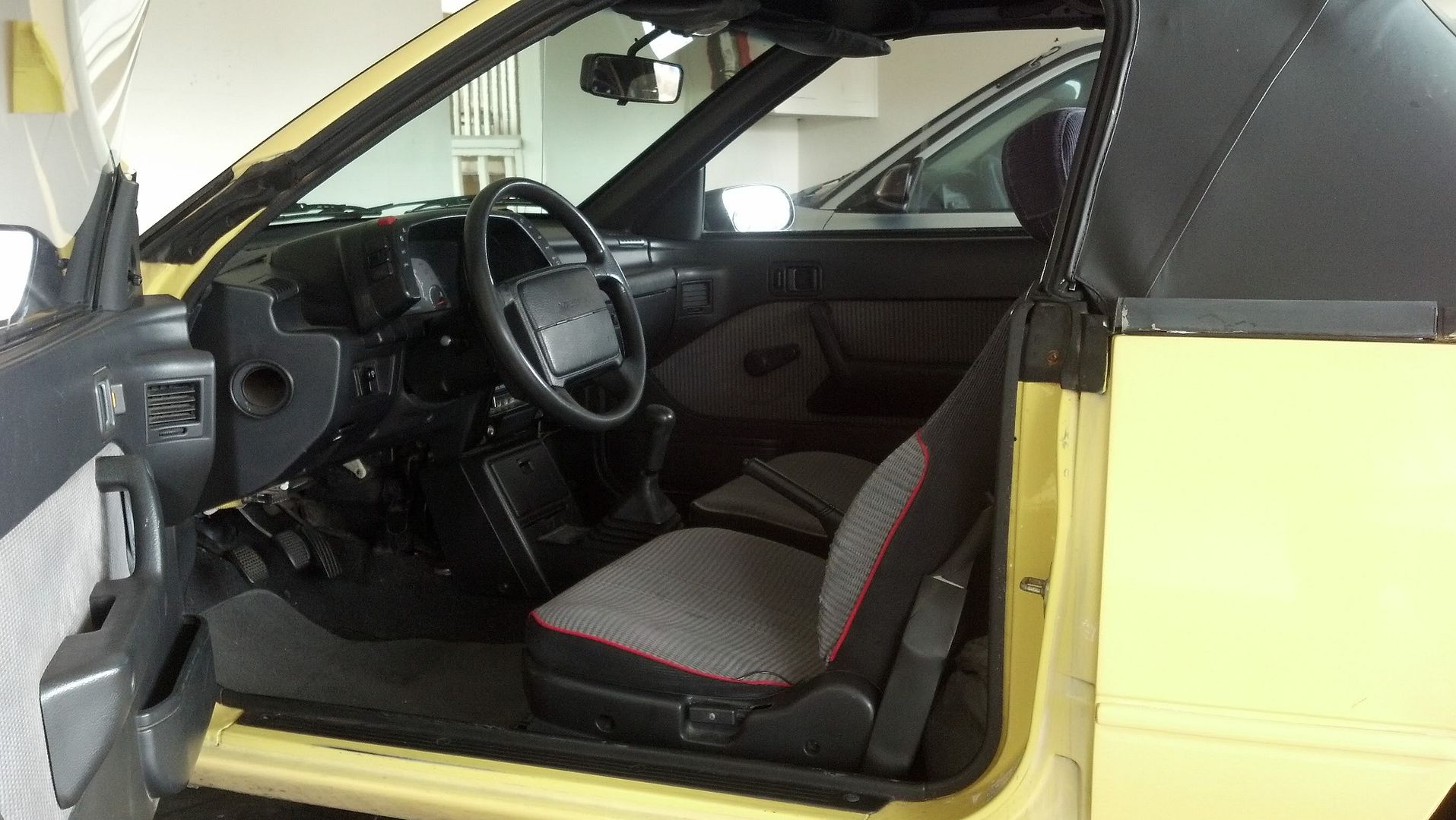

Its manual. Last service shows a compression test. 1 100 110wet 2 135 150wet 3 100 150wet Pretty crappy numbers. Time to research parts and suggested engine mods. ![]() ![]() Btw im a toyota guy. Currently own an 86 cressida and 87 supra. Lady has a 93 Camry v6. ![]() Edited by mecevans, Jun 2 2012, 12:43 PM.

Some light reading suggestions.... 98 Metro Rebuild Engine Rebuild Top and Bottom Detailed 1.0 Head Rebuild Guide Bottom End Rebuild Guide Rebuilding Hydraulic Lifters Engine Torque Specs Engine Rebuild Kit Thread eBay performance head gaskets Engine Rebuild Post #1 with pictures Engine Rebuild Post #2 with pictures/URL] How to clean a G10/G13 Oil Pump For mods I'd suggest anything in my signature below ... but your GF may prefer a mild economy cam from 3Tech? http://geometroforum.com/pages/3Tech Or would she like a nice race header?Nice plug wires. What's below and to the left of the hood latch? |
| mecevans | Jun 2 2012, 01:50 PM Post #8 |
Air horn :D. Anything to improve mpg, fuel econ or power. Seems like most do not machine block or head?? |

Nice find, mecevans! I like the color
