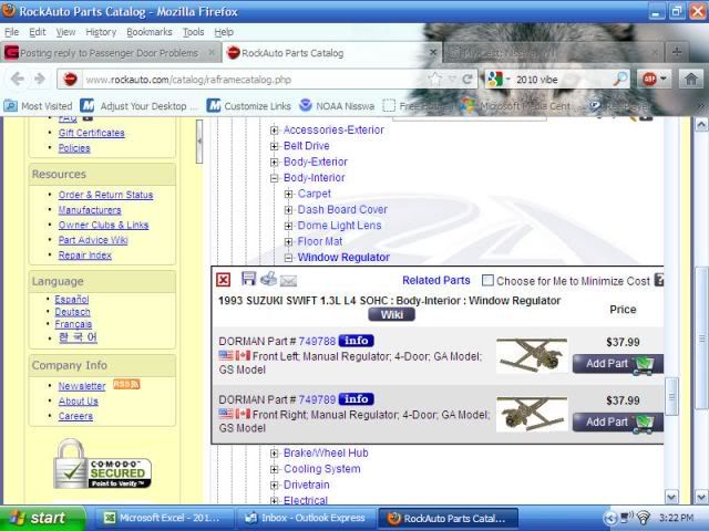

http://www.partstrain.com/store/?N=0&Nr=AND%28universal%3A0%29&PN=0+9331&VN=4294967142+4294963171+4294965332+4294967132+4294965707&domain=partstrain.com&Nr=AND%28universal:0%29
And how bad that you want a new one. :news Rock Auto is a couple bucks less. :deal
econoboxer
I am the one on the left.
Snowfish- Isn't this for the four door?
You know, now I'm not sure. :hmm It's the same ACDELCO Part # 91176912 as Rock Auto for $127.79. :news
Neither Rock Auto or Parts Train specifies. :hmm
econoboxer
IIRC(If I recall correctly) Metroschultz found these to be the parts for the four door.
I wonder if this is the right one? :hmm
:news :type :hmm
For that price, I may just put new ones in too! :thumb
edit....... :smackface never mind.....says 4 door :die .....I'll go back to work now............. :gamerz
