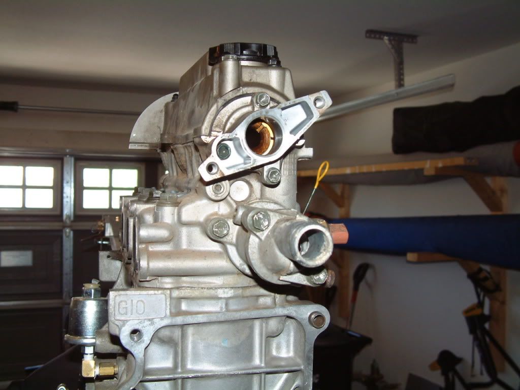

Hi Glenn, et al., Well, my third attempt at replacing the gasket (with the recommended felpro and black ultra rtv) still results in coolant leaking. I did "mill" the face of the thermostat housing on my belt sander before installing again and I got it nice and flat, but "something" is still leaking. After a look at a picture of a head, it looked to me like it may have been the freeze plug as shown in this pic (thanks geoflyer): head view A close inspection tonight after my drive home from work shows no visible leaking coolant at the freeze plug (but I am not getting a direct view of the plug), none at the hoses off the thermostat housing, and dampness at the water outlet flange gasket. I think I'll have to take it apart yet again and check the face of the flange on the head for flatness as well while inspecting the hose fittings and sensor fittings to see if it could possibly be leaking somewhere besides the water outlet. John Edited by jaevans, Jul 23 2012, 08:12 PM.

Good catch, sphenicie. There is an oil drop by the bolt under the distributor housing. I'll see about replacing the O ring tonight and check the distributor seal as well. There is, however, still a coolant leak - the reservoir drops about 1/4 inch each day and there is coolant on the block adjacent to the transmission housing. After looking at shots of a block, I was hoping the freeze plug was leaking but there is no evidence of that on mine. Still, the gasket is wet with coolant and I can find no evidence of a leak elsewhere in that area. I'll take it apart again this weekend and check for flatness on both surfaces.
