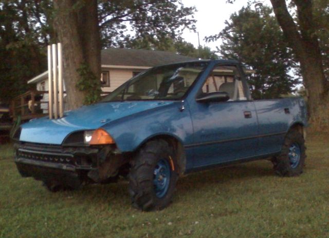

Frame horns can be welded, panels replaced, painting done with a can or roller and you can make the camo beater into something respectable.
Johnny's Ecomudder: http://geometroforum.com/single/?p=670979&t=4526891
And someone's show truck....
