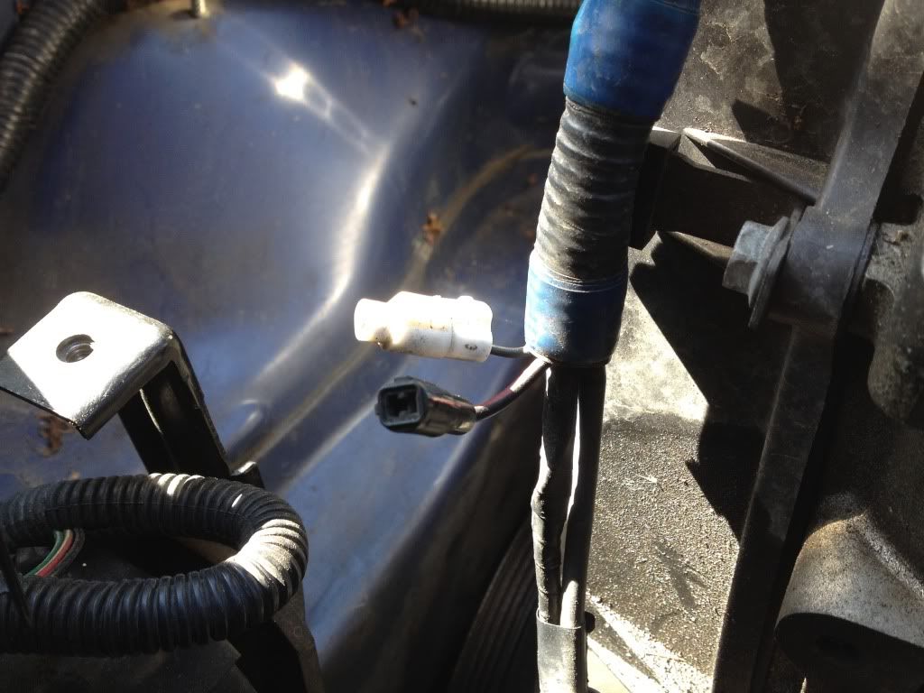

are you talking about this one woodie? [/IMG] [/IMG]
Edited by IanGeo, Jul 26 2012, 07:48 PM.
| Woodie | Jul 27 2012, 05:50 AM Post #8 |
Uh, no, that's the exact opposite spot from where I described. That's for power steering. The other end of the engine, closest to the battery. It's two or three wires, either black or green, that all hook up to a round eyelet, then get bolted to the metal of the engine. Unbolt, clean, rebolt. |
