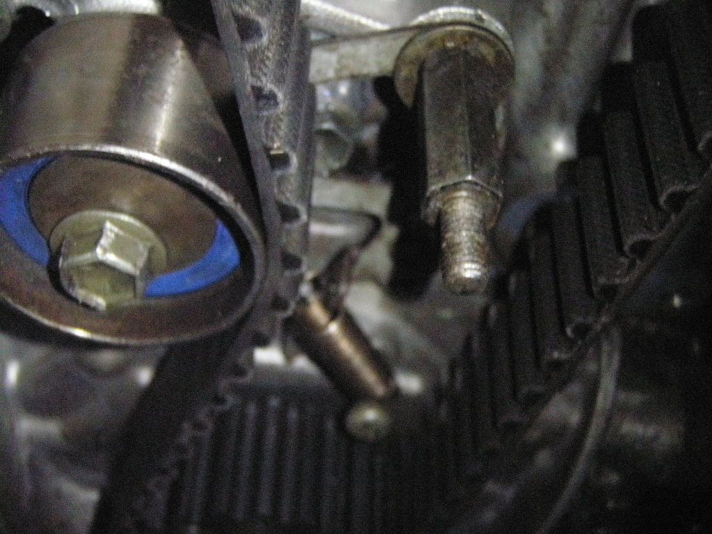

| rob68cal | Aug 3 2012, 07:37 PM Post #10 |
Edited by rob68cal, Aug 3 2012, 08:01 PM.
| Memphis metro | Aug 3 2012, 08:00 PM Post #11 |

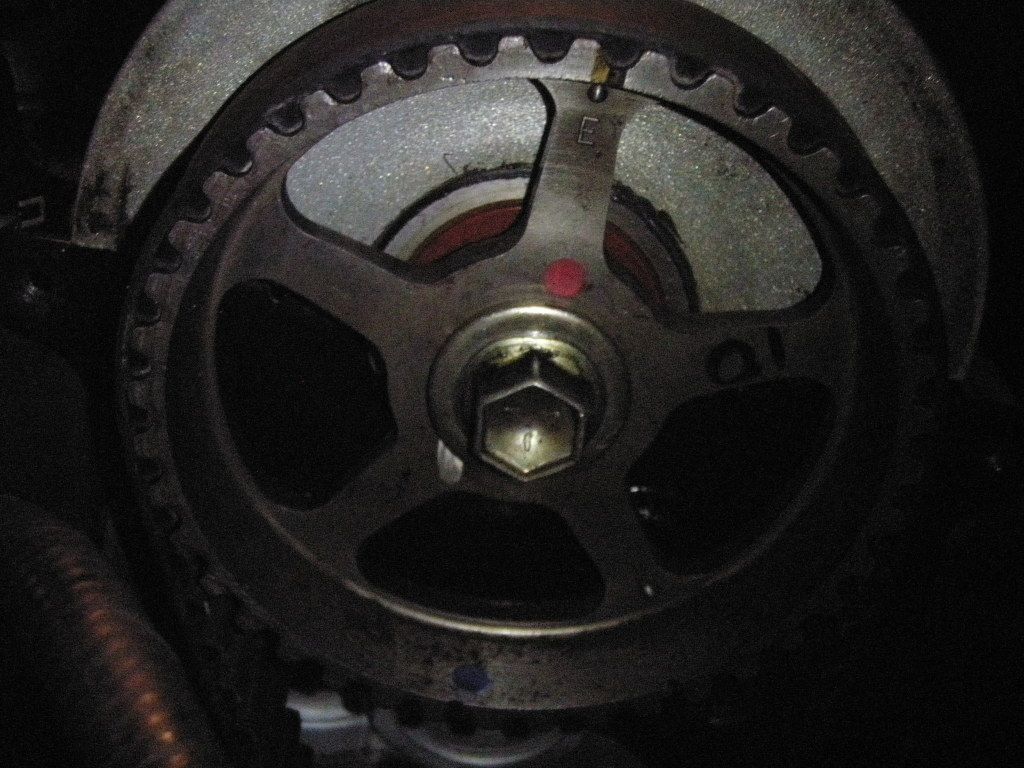

Its hard to tell from the picture but the crank gear appears to take the square tooth belt. What year engine is this? Have a picture of the cam gear? |
| rob68cal | Aug 3 2012, 08:06 PM Post #12 |
It is a 96 G10
Edited by rob68cal, Aug 3 2012, 08:09 PM.
| Memphis metro | Aug 3 2012, 08:20 PM Post #13 |
Once you installed the belt, did you rotate the engine a time or two and recheck the belt tightness as well as verify the timing marks are still on the money? |
| rob68cal | Aug 3 2012, 08:21 PM Post #14 |
No. doing it now. |
| rob68cal | Aug 3 2012, 08:26 PM Post #15 |
Didn't help. Still loose, The marks lined up tho.
Edited by rob68cal, Aug 3 2012, 08:31 PM.
