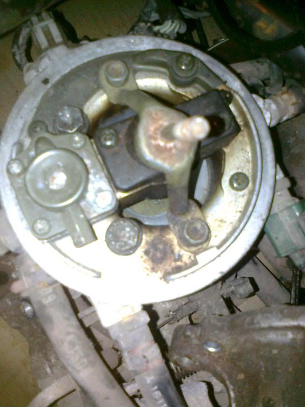

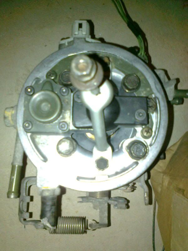

If you have one spoked sprocket and one stamped steel sprocket the ign system on the cars is, in all likelihood, not the same. Are the throttle bodies identical? If not then you need to use all the parts from the car the engine is being installed in. The intake manifold, throttle body, distributor and ECM all need to match. The cam sprockets changed sometime in 93, May I believe according to literature. Both types of ign and throttle body were found on 94 cars. They were called regular emissions and "upgraded" or California emissions. |

Which of these throttle bodies looks like yours? The difference is that one has 4 boltheads visible holding the throttle body to the manifold and the other has two boltheads visible and two hidden (shorter bolts). Are both yours the same? This is most important. Four visible on this one ![]() Two visible on this one
| cwatkin | Aug 5 2012, 01:33 PM Post #15 |
