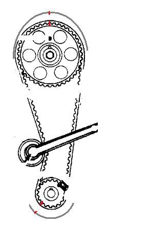

The main issue is, it won't run right, barely idles etc and I think I am one tooth off on timing somehow. I have attached some diagrams of what things looked like.
Before I loosened the tensioner, I used a sharpie to draw across one tooth of the top sproket, the timing belt, and the top back timing cover. I also drew the same on the bottom sproket and a mark on the lower case. This would be illustrated by diagram 1.
Now, I didn't remove the timing belt to get the old WP out or the new one in, I just sorta manuvered the belt. I was pretty darn sure I didn't move anything timing related. However, after I got the tensioner back on and tight[er] than it had been, I noticed that although the marks on the sproket and the belt still lined up perfectly at the top, the mark on the back case was a little off from the other two marks. I checked the bottom sproket, and everthing lined up what looked to be exact, i.e. the belt/sproket mark was dead on, as on top, and the mark on the case seemed to be dead on as well, unlike the top case mark. this would be diagram 2. I put it off to the case flexing or something, and put it all back together.

diagram 1
diagram 2

I am leaning towards a timing issue. The fact that the marks I made on the bottom ALL lined up, and the marks I made on the top, only the belt and sproket marks line up EXACTLY, I think somehow the upper [cam] pully moved a tooth on me while I had the tensioner off

I have installed my belt as per the marks, but after rotating the motor a few revolutions it is off a tooth. Be sure to rotate you motor with a ratchet to make sure your marks are still correct.

OK, so the consensus seems to be timing. Sure seems like a timing issue.
One thing, per my drawings - when I thought about it, I didn't see any way the top marks could be aligned on the sprocket and belt, and off on the case while the bottom marks where all lined up perfectly. I put it off to something on the case flexing, or sight inaccuracy on the bottom, as the edge of the case is much further from the sprocket down there.
If that is in fact possible, as per my diagrams, would someone please explain how that could happen?
I think I mentioned I didn't take the belt off. Could I have set the tensioner to tight or something? I'm pretty sure it's not to loose. what is the procedure for setting/installing the tensioner?
OK so it seems like I need to take the belt off and set it manually. I will re-read one of the many excellent threads on the topic posted here, one quick ? though - which way should I be turning the crank / cam when I align them? clockwise or counterclockwise?
When I was taking the bolts off the crank pully, I rotated the engine a bit in both directions. Is that bad?

490k
For starters, you need a manual.
When you put tension on the tensioner pully (the 3rd little one) you have to remove all slack from the other side of the belt.
It's not difficult, but you have to have the timing marks on both pulleys in the proper position. Marks on the belt are useless as they don't wind up in the same spot after you rotate the engine.
