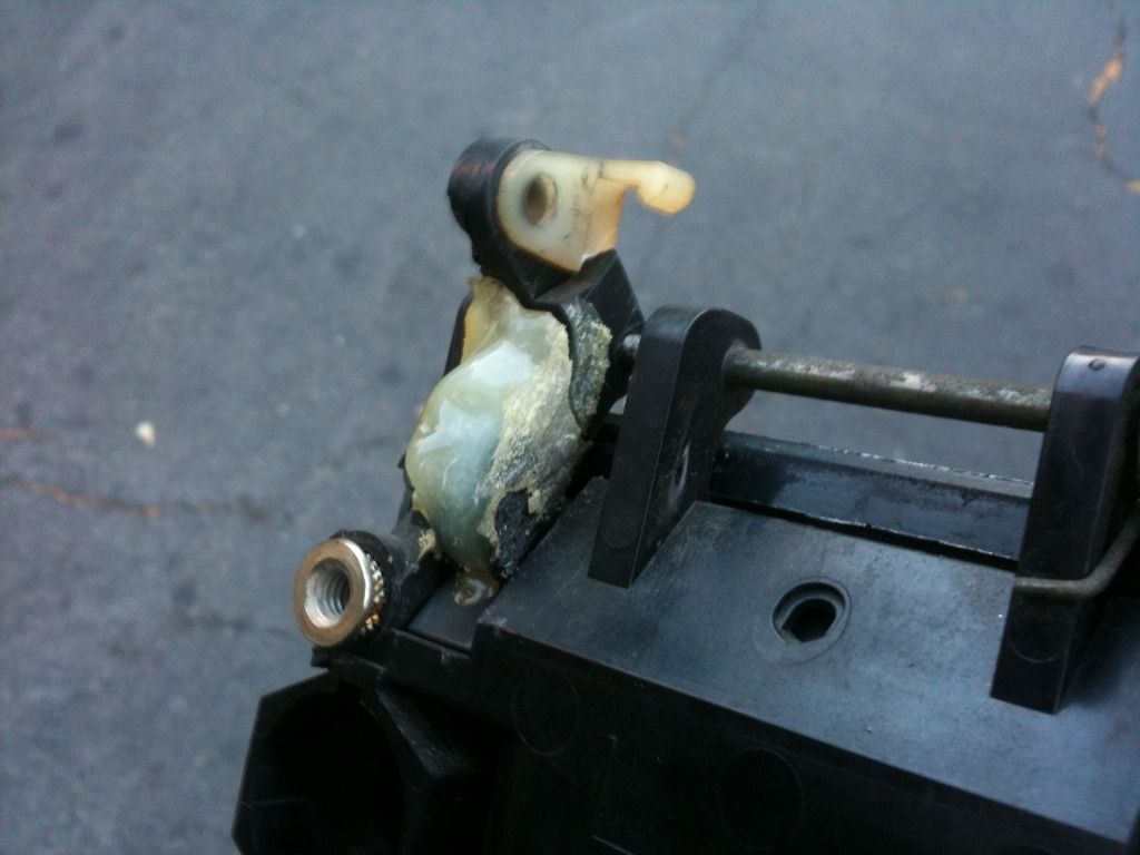

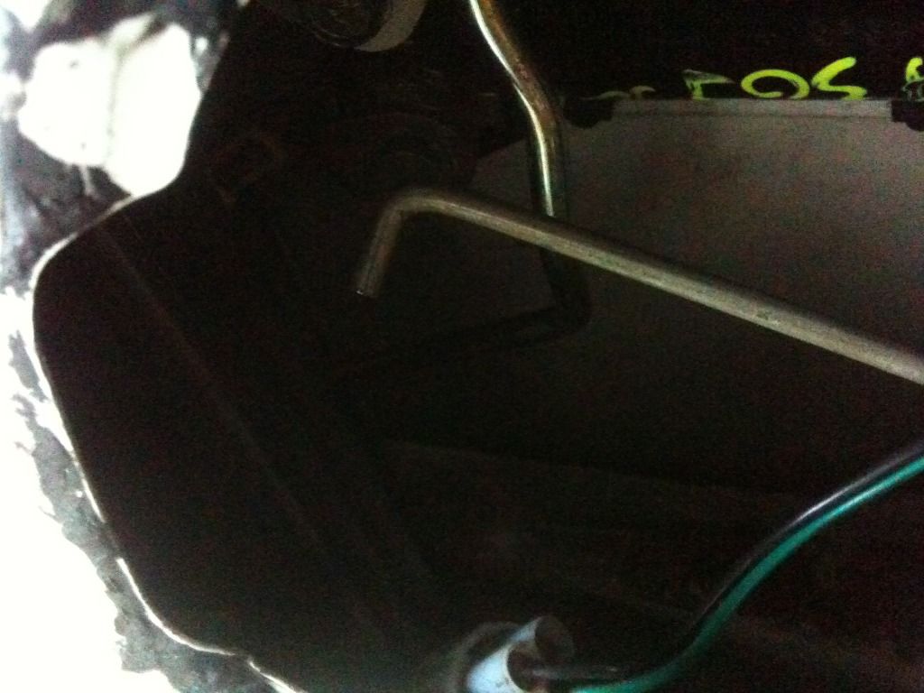

Hey Guys, So I finally got around to switching out my drivers side exterior door handle. Once I got the door panel off and looked at the faulty handle I found that It looked like it had previously been tampered with. From the looks of the picture I think somebody super glued part of it together, and that was causing problems with me opening it. ![]() However during the process of taking the panel off the locking mechanism for the inside door handle popped off and I'm not quite sure where its supposed to go back into. Does anyone have any words of wisdom...? ![]() Edited by mkell91, Sep 22 2012, 10:15 PM.
| idmetro | Sep 23 2012, 07:16 PM Post #11 |
It does look like someones fix wasn't so successful. Congrats on your fix! |
