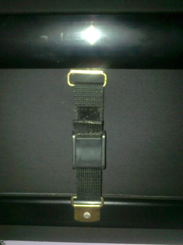

I am not sure if yours is the same but mine has a steel loops on both sides. In my case a cinch strap used to tie cables, extension cords etc. would be just the ticket. I use them for cords at work and they would be plenty strong. http://www.cableorganizer.com/cinch-strap/?gcsct=0ChMImL2W2o6YsgIVQ2nnCh0wWwAAEAI?gcssku=VW9-N09-1![]() Here is mine.
| t3ragtop | Sep 2 2012, 07:30 PM Post #5 |
good pic, clark. ![]() yeah, the plastic tension clamp sometimes breaks on the factory straps. clark's solution was what i accomplished with the velcro strap. |
