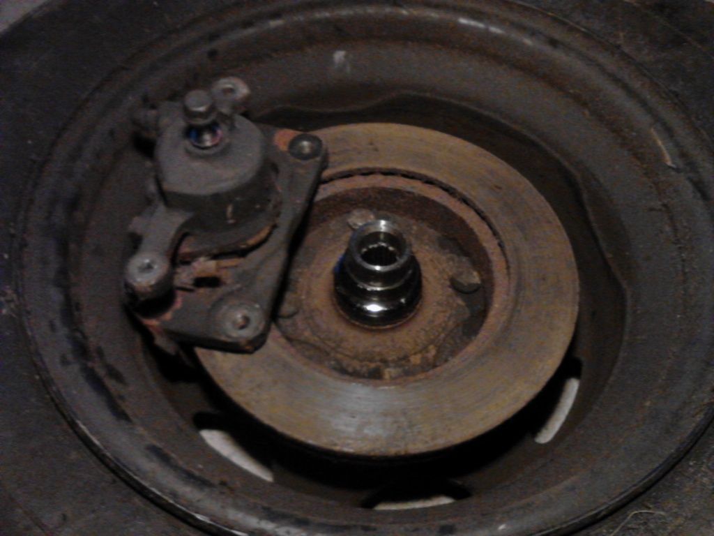

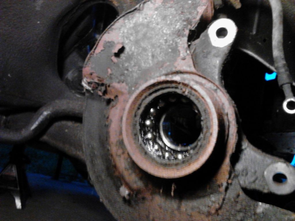

metro_neel
I just had the same problem....here is how it ended up coming off....
starscream5000
Got 70 MPG?
So you just unbolted the cv axle nut and removed the wheel and hub assembly together?
