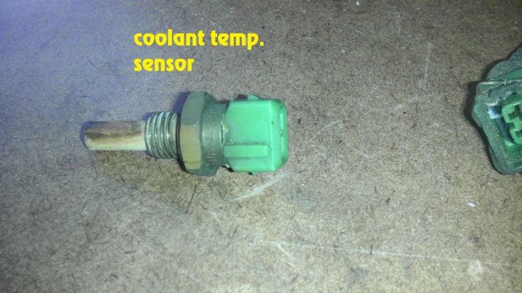

coolant sensor? as in temp gage inside the cabin or a different temp gage? Would a code scan have sniffed this out? Coolant sensor provides information to the ecm and assist in fuel trim.
Coolant gauge sending unit provides guage signal. Two differant componets on his car.

coolant sensor in the throttle body...the sensor had a resistance showing it was stuck on cold ...computer went full rich...no code set, probably due to the ecm thought the engine was always cold...

here are some pics...
 sometimes the connector will slide off if you push down on the center of the wire retainer...
 some coolant sensors mount on the opposite side of the throttle body...

Sweet... looks like an easy fix, thanks for the quick reply! I just ordered a new sensor online, I'll post what happens after I install.
