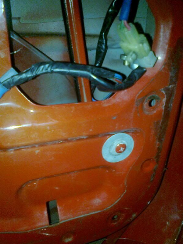

I had the same problem with the driver's door on Littlest Hobo when I first got him. I found the tracks kept moving and allowing the window to jump out. I added a reinforcing washer to the bottom mounting screws of front and rear tracks. It has been over a year now with no problems. Also I regularly use a silicone based lubricant on the guides and it also helps a lot. The wires hanging in the door in the pic are from the electric windows I have now installed. They are from my Swift GT donor car.
