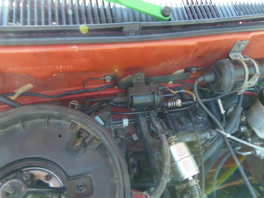

when you turn the AC on there is a "thingy" that idles up the engine to make up for the additional power drag on the engine at idle. check the "thingy", its not working.----------comeon guys, I cant remember the name of the "thingy".............. |

IAC http://geometroforum.com/topic/4074513/1/?x=40 |

Ok, and where is the IAC LOCATED. |

You may have an ISC if your 1994 has upgraded emissions. It's a black rectangular box on the back of the throttle body. It has a plunger that pushes on the throttle plate. Have someone turn the ignition on while watching it to see if it moves any. |

You may or may not have one of these, if you do its either not working, or you need to adjust the screw on it.

Ok, I will have to take a look. What will I need to adjust it? Nothing special I hope. I ordered and engine mount from rock auto but if it is just the IAC or whatever it's called I will just ship it back.... |
