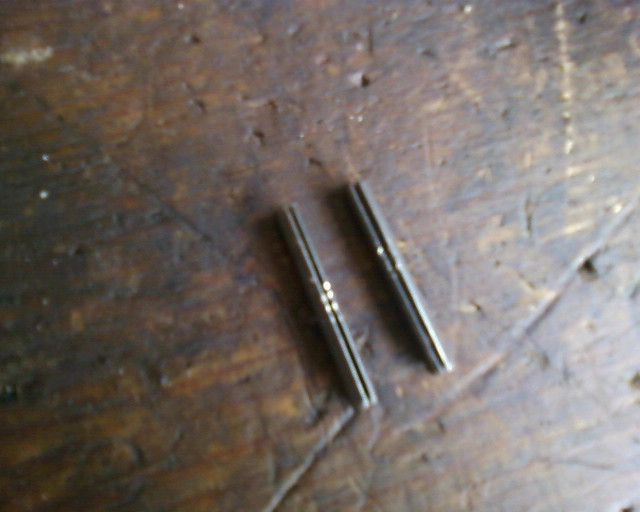

I just looked in my magnetic tray and saw these in there, the only pin I recall removing was the one to hold 5th gear selector in place. The pin for 5th was wider than these, but now Im thinking that I missed something?
