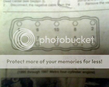

| Geeeo1 | Sep 23 2012, 11:14 AM Post #1 |
Does anyone know it? 97 1.3 |
| Deleted User | Sep 23 2012, 12:30 PM Post #2 |
If you want a sequence, use the tightening sequence in reverse. |
| G.O. Joe | Sep 23 2012, 12:40 PM Post #3 |
4, 6, 10, 8, 2 1, 7, 9, 5, 3 This is loosening. Tightening is the reverse. I edited to try to get the spacing right, but to no avail. I'm sure you can figure it out! One more edit. Here's a kind of crappy picture.
Edited by G.O. Joe, Sep 23 2012, 12:52 PM.
