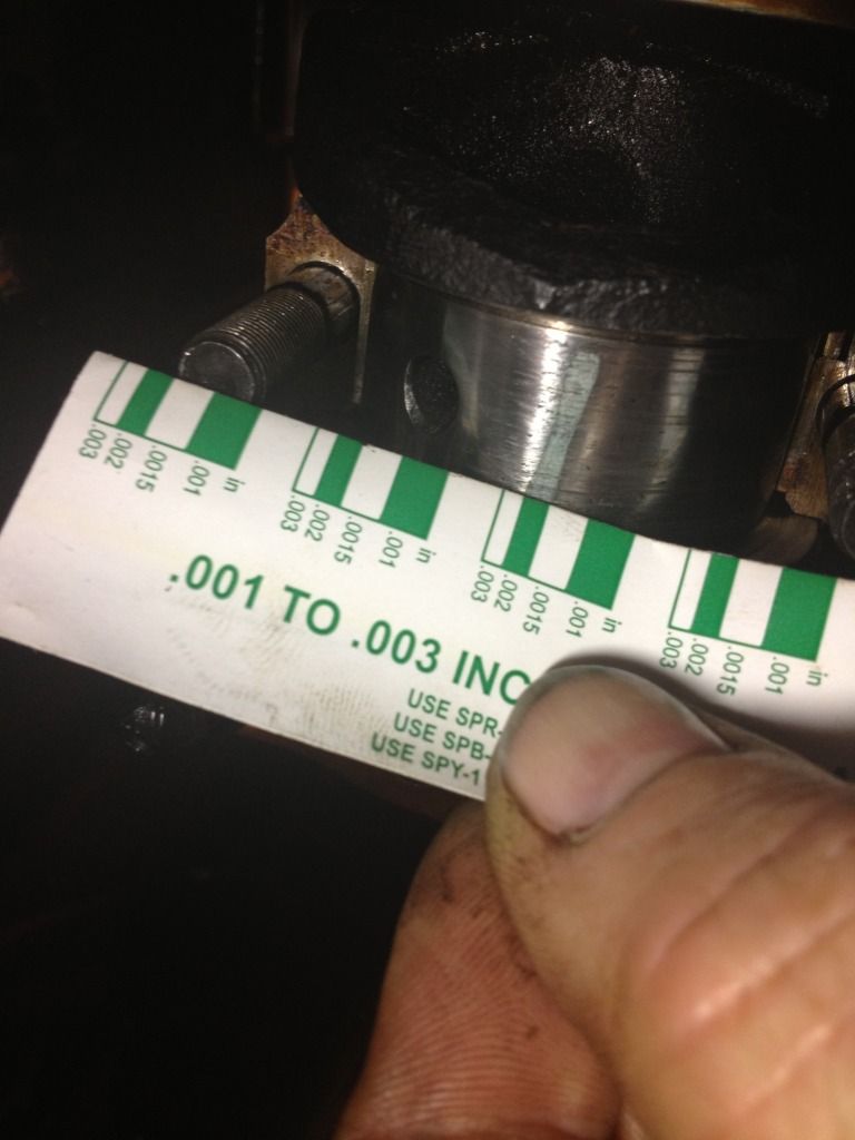

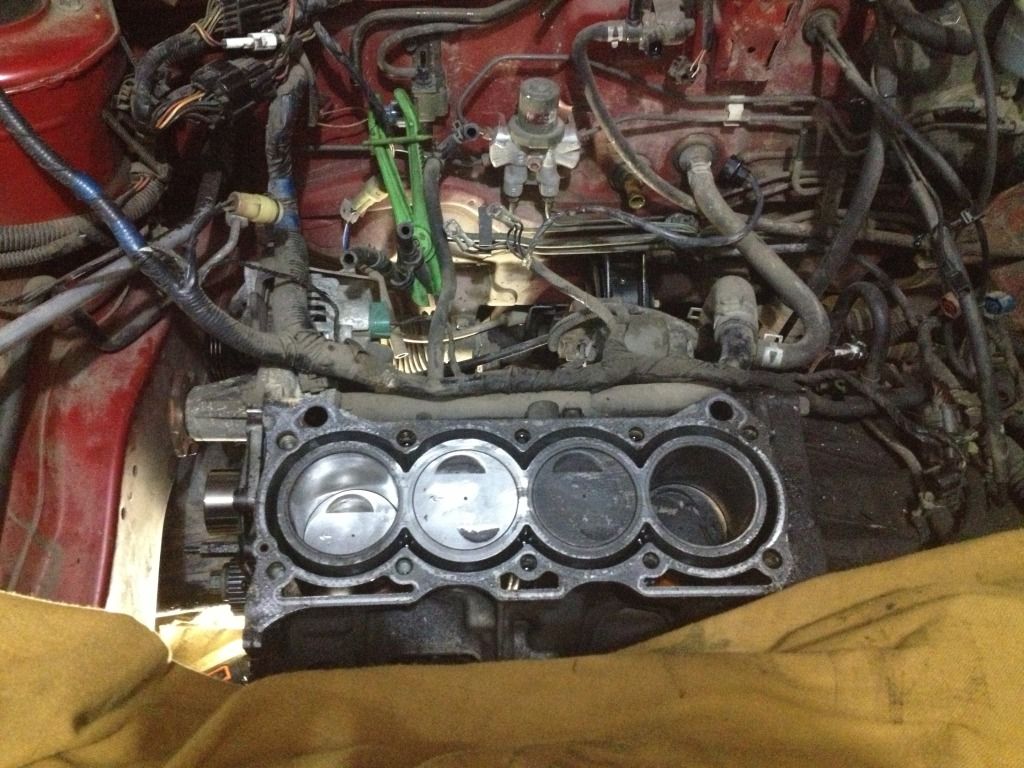

Ok I know I asked and you gave your Opinion. I don't have the money to drop the crank and go to machine shop, even though we all know that is the right way to go. [IMG][IMG]http://i1088.photobucket.com/albums/i326/Randy0157/2012-09-10016.jpg[/IMG][/IMG][IMG][IMG]http://i1088.photobucket.com/albums/i326/Randy0157/2012-09-10015.jpg[/IMG][/IMG][IMG][IMG]http://i1088.photobucket.com/albums/i326/Randy0157/2012-09-10017.jpg[/IMG][/IMG] I'm stubborn and though I did ask for opinions I have to go with my wallet. The crank cleaned up well and PG was not too bad. Thank you to all who helped. Spoke to Geo Glenn today and got some links to where to buy some rings and bearings and a head gasket. Going to go through the oil pump and make sure it's Ok. Found out the oil pick up mounting is broken so I'll pick one of those up this weekend.

Make sure the oil hole on the journal is not restricted. |
