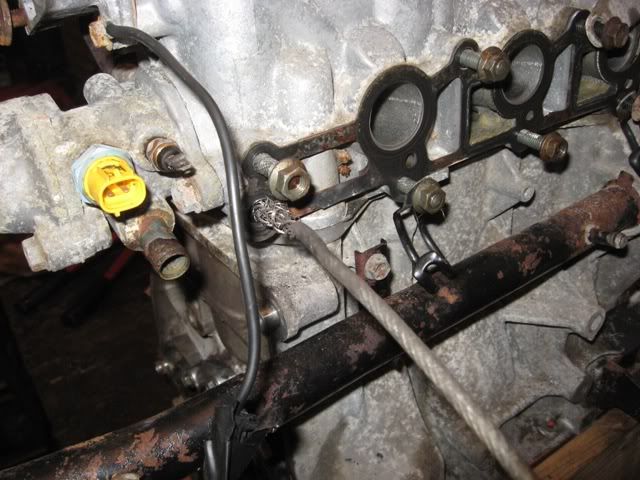

I knew I should have taken more pictures! Anyway, cleaning the EGR & ports is pretty straight forward. Spraying cleaner, into the ports, does little to nothing. They have to be reamed.![]() My picture shows the intake off, but that's not necessary. Remove the EGR. With the drill and low speed, and plenty of carb cleaner, you should be able to get all the way through to the exhaust manifold & intake. Rinse well and dry with compressed air. With the exhaust and intake valves closed, on cylinder 3, you'll hear air blowing into the exhaust pipe. You'll know that you've got all the way through the intake by the sound, of the compressed air, through the throttle body. For the EGR valve itself, just use carb cleaner & a brush. You may have to gently scrape the heavy stuff with a screw driver. Careful not to nick the shaft, though. Get a new gasket and you're done.I did this process, to my Wife's former 93, with no problems. Other than the car hating to swallow all the residual carb cleaner/liquified carbon. Smoothed out with a couple revs. For the temp sensor, I Did Not Test. I just through in a new one. Problem solved.
