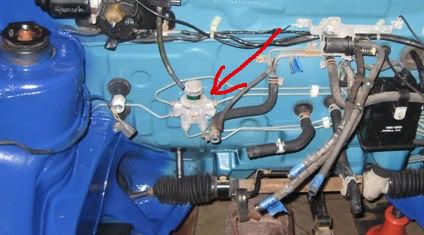

I'm going to get a new caliper for the front and disconnect the lines throughout the system to figure out why the right rear's not getting pressure this weekend, but for now, can any experts on here help me with regards to what you think it might be? Or, let me know what all is in the brake system as I am new to metros and don't know what's all included as a whole. All I could see is the master cylinder which has 3 lines going to the passenger side of the engine bay on the firewall which I imagine is some sort of brake force distributor, then 4 lines out of that going to their respective wheels. My theory is that since the master cylinder has only one line for the back two brakes and since the back left is working, the master cylinder must not be faulty. It's either the "brake force distributor", the lines from it to the right rear, or the brake piston in the right rear.
Is there anything else in the brake system that I'm missing? Is my theory correct? What is the proper name for the "brake force distributor", if that even is what that thing is?

It is a split diagonal system. LR and RF on one circuit and RR and LF on the other circuit. The two rear brakes have no interconnection.
Does the RR brake work? Jack it up, hold the pedal down and see if you can turn the wheel. If the brake works then the blockage is right in the bleeder or the wheel cylinder. If the brake doesn't work then check for loss of pressure elsewhere.

Brake experts: can you explain how it's a cross-over brake system if there are only 3 lines coming out of the master cylinder? I understand the reason for pairing up opposite corners, but am not sure how that works. Is it like one of the front two lines in the master cylinder being LF/RR and the other is RF/LR, with the third being a return line from the proportioning valve?

LF and RR come out of the front of the master. The LF comes directly from the master to the caliper. The RR goes to the proportioning valve.
The other two, LR and RF are fed by a single line from the rear of the master and that line also goes to the proportioning valve where it is teed into two. One to the rear and one to the caliper.
