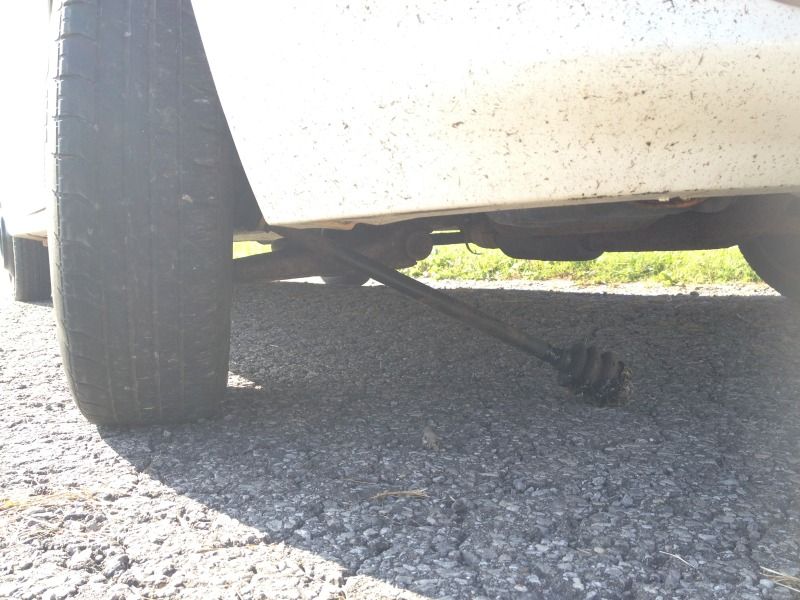

![]() I have the chassis rot issue near both front control arms, planning on welding it up as others have done here. I took the car down the road to keep it rolling in the meantime and snapped the front passenger axle while lightly braking and turning left. Car came to a grinding halt. How bad is it, that it's broken on the transmission side? Car does not drive in any gear now. |

It should pull right out. If it doesn't you can try to gently pry on different parts of the CV axle input with a crow's foot (flat crow bar) |

Thanks. So I'm guessing I should replace the whole thing? I think this is what I'll need but not sure: http://www.cardone.com/Products/Product-Detail?productId=661303&p=rock $43 at rock auto.

Check this out: http://geometroforum.com/topic/4691320/1/ |

Cool! I'll see if I can remove the broken pieces this weekend and see what I have to work with. Thanks again =) |
