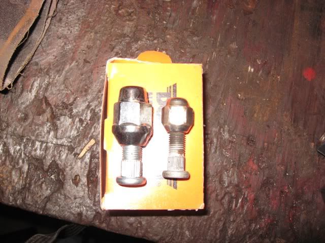

The hub & drums will need to be drilled. The 12mm will not fit in the 10mm hole. No such thing as "just" boring the holes. A lot of material will need to be removed. Drill press would be highly recommended.Comparison of 10mm vs 12mm ![]() If I had to do it again, I'd spring for a true 12mm drill bit. As you can see by this chart, http://bobmay.astronomy.net/misc/drillchart.htm there is no exact match SAE bit. If I recall, I used the 15/32, in a drill press, and then Carefully reamed a little with a hand drill. Press in the stud & seated with an impact.Take your time. Drill slow and use lots of cutting oil. On my pending 91 project, I'm using 95 knuckles, hubs, & drums. Disc rotors are larger and the 12mm studs are already present. |
