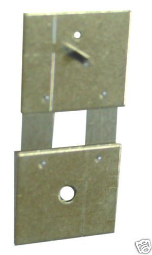

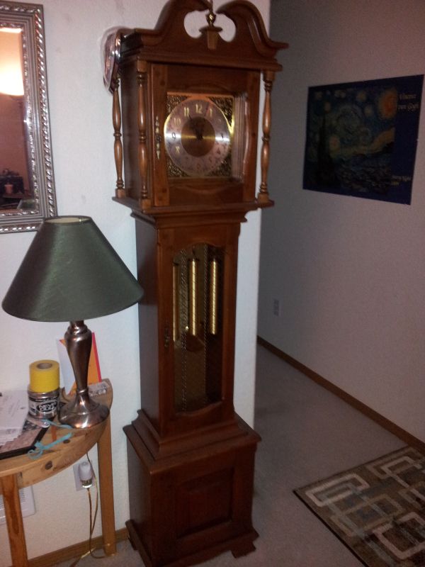

Got a very nice grandfather clock for $40. It needed a $4 part.
what was the $4.00 part? And is it a real clock that runs off weights?
It does run off of weights. Heavy ones! ^o)
The $4 part was a "pendulum suspension spring". Sort of a standard part. They only made a few different clock movements like this back then, and they were used by a number of different clock manufacturers. Parts, much to my surprise, were easy to find on the net. You can even buy entire new movements if yours wears out, but they ain't cheap.
The spring is pictured above...upside down. The top half with the hole attaches to the movement, the bottom half with the knobs attaches to the pendulum. The two pieces holding them together are very thin and flexible spring steel. One side of the spring was broken, so the pendulum was cocked at an angle and twisting around a bit when it was swinging. This kept it from keeping good time. Further, it is a Westminster chime and the movement had also been knocked slightly out of position inside the case. So the hammers were not striking the chimes properly. That probably happened when it was being "dropped" off at Goodwill. Sorted that out and it has been great since. It sounds the hour and quarter hour.
Despite being over 40 years old and having last been serviced in 1992, it keeps almost SPOT-ON time! I have to adjust it forward about 2 minutes every 3-4 months.
Best $40 I ever spent! :thumb

And BTW Cobrajet25 your beautiful clock is a Grandmother clock not a Grandfather clock. Funny but true, Grandmother clocks are slender in the middle; Grandfather clocks are much bigger, especially in the center. :rofl
Got one just like it, From the thrift store! ($75)
Is it an Emperor? Very similar in design but I can't quite tell. Used to live just down the road from the factory in Fairhope.

Hmmm...it is an Abel Cottey, made by the New England Clock Company. It has a descriptive label inside it with a date of 1971.
It is my understanding that grandmother clocks are narrower overall and usually under 5'9". This one is 6'2". It does have an 8" dial (rather than 10"), but is chain-driven and has an 8-day movement. It is my understanding that grandmothers are usually spring-driven. So I am not sure exactly what it would be classified as. Probably depends on who you talk to. Hard to categorize long case clocks sometimes?
Maybe it is a SMALL grandfather...or a BIG grandmother?
BTW, the label inside the case says "Abel Cottey Grandfather Clock". :hmm
Oh well...it was cheap, and it is cool! :thumb
Stiffchezze
Sir Metrologist
I guess it does hinge on who you talk to. I have the exact same design from Emperor and they say it is a Grandmother clock. :hmm
Either way, nice clock! :thumb
I would love to come across such a deal. Been into clocks and watches for a long time, finally got around to rebuilding an old Seth Thomas mantle clock. Spent about $200 on tools, bushings, lubricants and a book.
I've bought my parts from Timesavers and Merrits.
